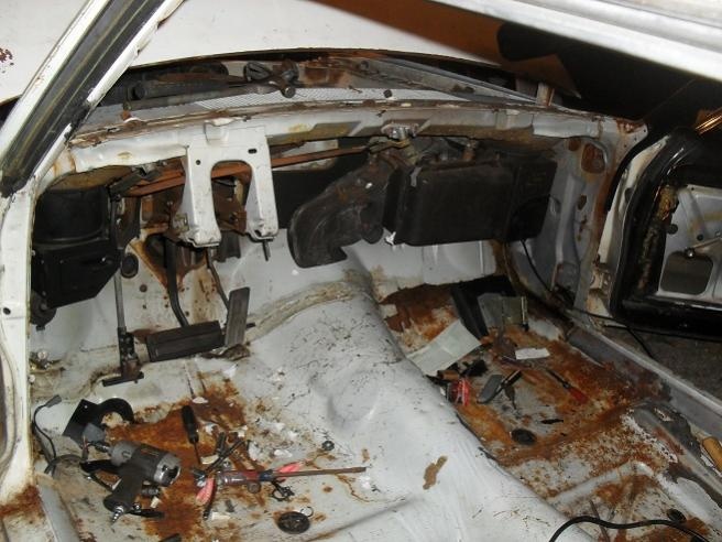

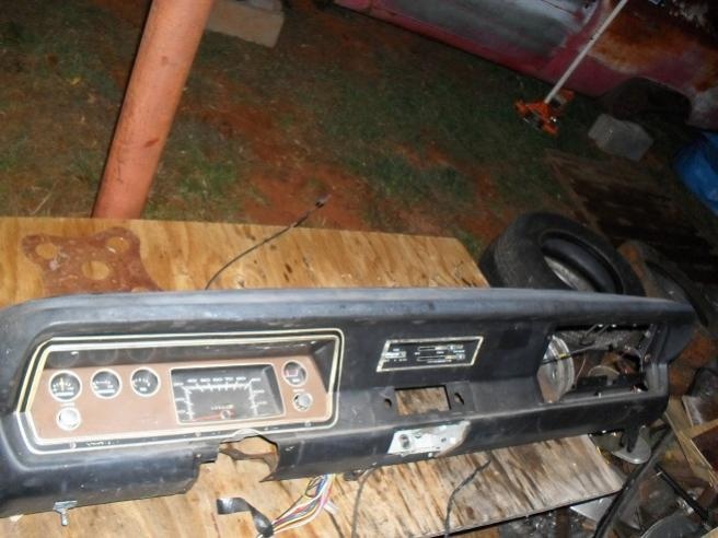

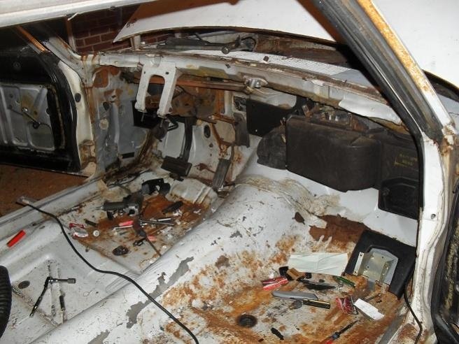

ok, so i got bored tonight waiting for wife to get home from work, so i decided to try to take the dash out.
MAN, I DID NOT KNOW IT WAS THAT EASY TO GET THE COMPLETE DASH OUT!!!!!!!!!!!!!!
ok, so it took me 45 minutes to get the column and whole dash out. pretty straight forward.
now i am sure it will be much easier to put the 4-speed hump, and pedals in the car

100.oo for the dash, with out the pad. ( i need idt for a cap.lol) plust the ride. there is no rust or dents in it
