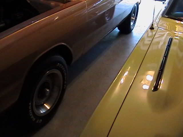

Here is a clear pic of a E70-14 on a 68 Barracuda and how it fills the opening.

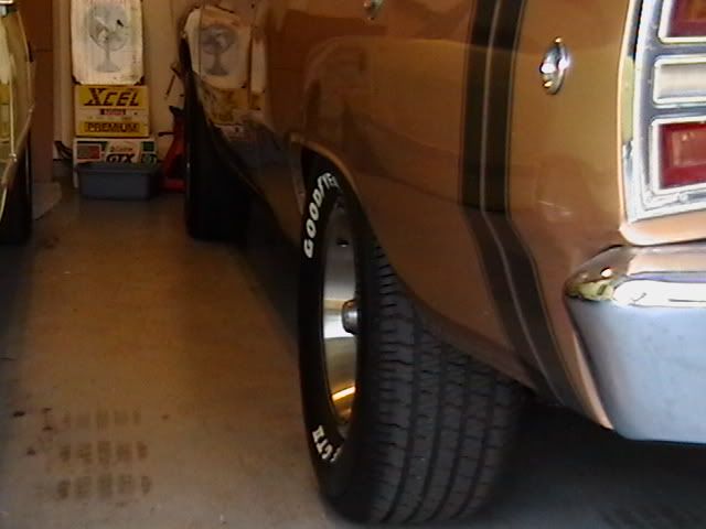

Here is my car with 225/60-15's on the front an 255/60-15's on the back;

This is my car with 235/60-14 on 14x6 rims all around. No rubbing issues at all.
