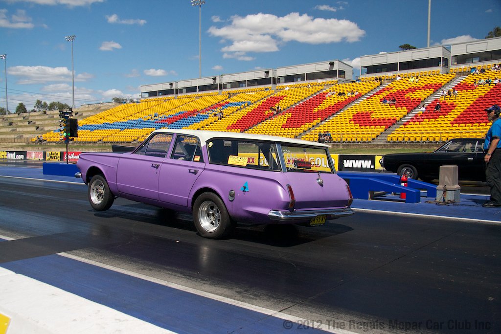

Here's a pic from the Test & Tune day it gets out the hole ok for stock rear springs, no snubber & street shocks 60's at high 1.5's to1.6 sec only stalling to 2000.
