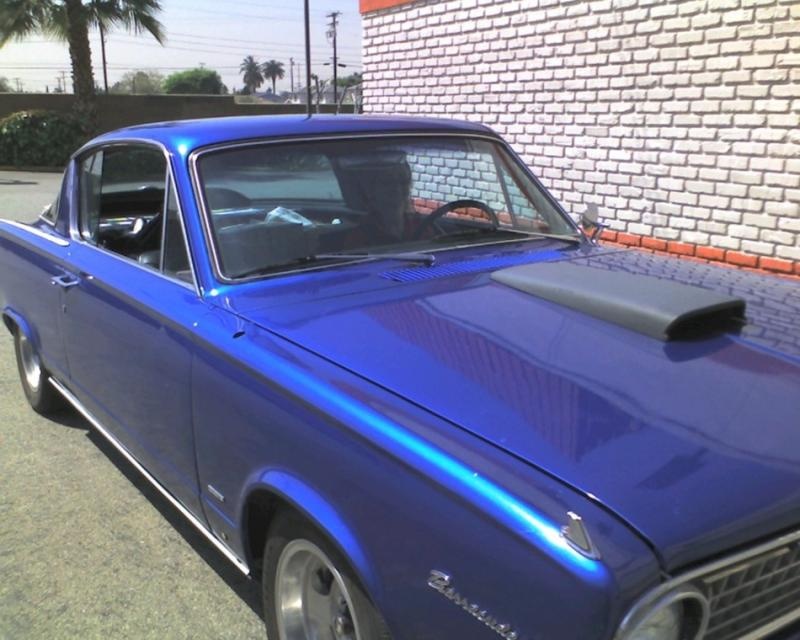

Yes, I know, I'm probably nutz, but I'm doing a 2200 mile cross country move and find the need to use my 66 Barracuda to tow my 87 CRX. The CRX weighs approx 1000 LESS than the Barracuda and will be flat towed.
:burnout:
I had the 904 a/t rebuilt approx 3 years ago (it is an early 70s model) and the 318 done 5 years ago. I'm not worried about the motor, but is there anything I should worry about with the 904?
Thanks!!!

I would be more worried about the brakes. What size brakes do you have on the Cuda?
If you only have 9 in brakes, I would not do it. 10 inch or discs, might be doable if you are carefull.
I would also add an extra trans oil cooler. Radiator might also be marginal.

trans cooler & make sure your hitch is solid, not just a bumper mount. good luck with the move ,Lawrence
Install a trans cooler. Keep it cool.

X2 on the trans cooler, pretty cheap and easy to install. Take it easy with the brakes, (i see a V8 badge so I assume you have 10" brakes or better) wouldn't be a bad idea to inspect them before you go, also check the brake lines. I would be a little nervous if you are running the old style master cylinder with the single brake line, blow one line and you lose all brakes. A upgrade to a newer style is pretty easy and not that expensive, and way safer.
You say the CRX weighs a 1000 lbs? Should have no problem pulling it but remember, don't fill the cars to the roof with other stuff, it may add a lot more weight, make sure you can see out the rear window. How is your cooling system? Your car may run a little warmer so be sure the radiator is good and all hoses too. I would make a check list and look the entire car over or have a shop do it for you.

Yes, the car is a V-8. The 318 was built in '07. I've done a few 4 hour+ trips with it through the desert in the alst few years. The car is actually the Formula S version (factory a/c, pb & ps) ... everything important on the car is at most 5 years old. Engine, trans, brake system (all but the power booster), charging system, cooling system, suspension (air shocks in the rear), hoses, 4 bbl carb, etc.
I was considering a trans cooler. When I built the car, this transmission (which was used & an unknown) was installed as-was. In '09 I went from Vegas to Phoenix. It was fine, until it took 3 hours to go 7 miles through the Hoover Dam area (steep hills) on the return trip. That toasted it & earned the rebuild (yes, I utilized neutral & even turned off the car periodically - next time, I'll just pull over). I'd guess that in 3 years, that rebuilt trans has less than 3k on it.
Cooling system is good, radiator was re-cored in '09 also.
Brakes are also good. Less than 3K on them as well w/all new lines & wheel cylinders in '07, plus I'll be carrying spare shoes, hardware & of course tools/jack/stands. Not that I want to be replacing brakes anywhere, but sh*t does happen.
This week I'm installing a new speedo, fuel gauge, heater core, backup light switch, tail light lenses, hazard light switch (never had one), hooking up the radio, finxing the windshield washer fluid system (we don't use that stuff here in the desert) and have already installed the towing light wiring harness. Oh, and she's got a good set of tires on her also.
I'm just more concerned about the a/t. I've done lots of towing over the years, but never a car/car flat tow combo. It's all involved a larger truck w/some sort of trailer.
Tow hitch ... well, since no one makes anything for the car ... I found a welder in Vegas that specializes in custom hitches. He's welding mounting brackets to the car, so that a standardized setup can easily attach. He's also doing the brackets for the CRX.
Looks like someone mis-read the weight on the CRX. It weighs approx 1000 lbs LESS than the Barracuda. Barracuda weighs in at appox 2800 lbs and the CRX weighs in at approx 1750 lbs.
