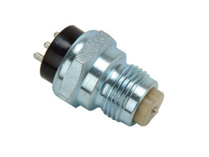

The plug looks like that one pictured. From what i am reading it is the nuetral safety switch most likely so do i need to use it? I thought my car has one already? If i do need to use it how do i connect to it and what do i connect to it? thanks
It's nice to have the neutral safety switch working if you don't want the engine to start in gear. Run a wire from the center pin on the switch to the connection on the starter relay if you want it functional. You probably already have the backup lights working. If it's a floor shift, the switch is under the console on the shifter bracket. If it's a column shift it's at the base of the column on the inside of the car.
