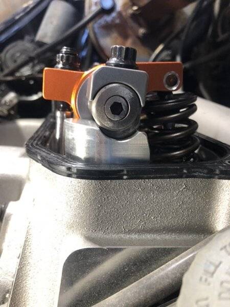

I just got my kit. I have comp pro magnums and trickflows. Looks like a fairly small correction compared to some I have seen.
Those look about the same size as the ones the I received from Mike for my PRW rockers. I remember him saying that the kits for the PRW, and Comp Magnums did not need a lot of correction on the TF heads. Also, since the TF's have taller pedestals, they requite less correction then say a stock based head like Edelbrock, for example.
He had mentioned that when I bought mine I think. The price for the trickflow kits are a little less I think.
It appears that the shims can go ether way on the head.
I have a set of TF small block heads @B3RE right now. Mike says as far as the geometry is concerned they are good right out of the box and should not require any corrections. I am buying the valve train from him as well, and he may have some proprietary mods incorporated there.
I also have a big block E-body that have trick flows, and i used the Harland Sharp valve train per TF and the geometry correction was pretty substantial.. about 1/4 inch up and back.. My smith brothers push rods were just shy of 10", but the geometry is right on.
Actually, I said the small blocks were the closest I've seen, but unless you are running .700" lift, and more with a HS rocker, they still need some correction.
