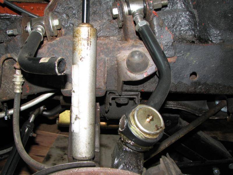

attachment.php
there is no penetration on the tube at the weld...!

again. there is nothing wrong with the tube arms if they are welded properly. cap obviously doesn't know how to weld. its a shame garbage like this is even being sold because it makes people think all tube stuff is junk which is the furthest thing from the truth.
I bought these arms from a well known vendor,not because they where cheap.The original arm on drivers side was rewelded when i bought car,so i figured i would go with something new.I never thought i would be putting my family or myself at risk.You would think a vendor would have a certain amount of faith in the products they sell...By the way,this vendor does not advertise the makers name,just says upper tubulars.Figured they would not sell junk...MY BAD!!
If they are using chrome moly tubing they shouldn't be using a mig welder anyway. Tig weld only on moly tube.

I do think they could get better welds from a high school metal shop student.
mancini?? can't for thr life of me figure out why they sell cap garbage.. should have asked here before you bought from them.i know i would have told you not to buy from them..
There is nothing at all wrong with using tube arms as long as the jackass welding them knows how to weld. The guys at cap obviously don't know how to weld.
I concur.Looks like poor to no penetration in that weld.

I've been running the CAP arms on my Challenger for well over a year now without problems so far. I didn't know of any issues at the time I bought them. This isn't the first time that I've heard about failures of CAP parts, but with the internet the story/evidence isn't always clear cut. It's COMPLETELY obvious based on those pictures that this was a weld failure though, and I'd have to say I'll be looking for a new pair of tubular UCA's.
And as Joe said, there's nothing wrong with tubular a-arms in general. They are used in everything from F1 cars to Baja racers, and in the case of F1, on cars that cost over 3 million dollars. Like anything aftermarket, there are different levels of quality. CAP has proven itself to be low quality at best. And unlike a lot of things, the CAP arms are not cheaper than the alternatives!
RMS, Magnumforce, Hotchkiss, Firm Feel and Just Suspension all have tubular arms that are quality pieces that I would run well before I ever went back to stock design UCA's.

It's probably just my own tendency toward over-engineering stuff, but the design gives me the creeps. Personally, I'd like to see a gusset that ties the whole mess together at the ball joint end. It wouldn't take much material to vastly improve force distribution on something this important. Nonetheless, even a well-designed gusset won't compensate for crappy welds.
a gusset isn't needed. hell in caps case it probably would have a shitty weld there too..lol. if its welded correctly there would be no problems..
