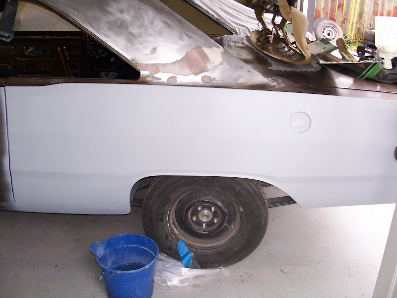

Worked on the driver side rear quarter panel this week end. Couldn't help myself had to shot some primer on it, now for the glide coat and some more block sanding.
I'm really wanting to get this thing painted by late summer so I have all winter to rewire and put it all back together.
