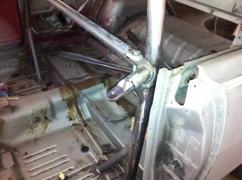

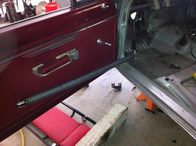

I do believe he was expressing a possible concern with a particular piece of that cage puzzle. I too was thinking about that snout bar that runs out to the shock mount and frame rail from the a-pillar bars. I was thinking the same thing about it collapsing in a direct impact to the headlight area at speed. It "Could" twist towards you shin and rip from the a-pillar bar. I didn't post anything about it but he might be right. I also thought you might weld in a cross bar from that bend to the other side and that would solve that issue without fail imo unless it interfears with the brake pedal....
Just sayn'... No Pun intended!! I have hit the wall at 100+mph so I have an idea what happens. My Falcon had a 14 point and still bent the a-pillar bar.
I know its a crude drawing but this is the area I am talking about,

I had my buddy who helped me with the cage over yesterday and told him about you guys concerns about the Forward Strut bars. He started laughing. He says the bar is welded to the front frame rail, welded to the shock tower and will be stitch welded to the inner fender well along with a plate on the firewall. He concluded with if you hit the wall head on or even at an angle at 100mph there is NO WAY that bar would ever hit or impale you. It is tied to too many other things for that to ever happen and I totally agree with him. He has seen his fare share of wrecks in his 30+ years of building race cars. So Enough on that subject.......
I totally agree with your buddy too. The snout bar is triangulated,one of the strongest engineering structures known to man. Impaled?
Not in our lifetimes..

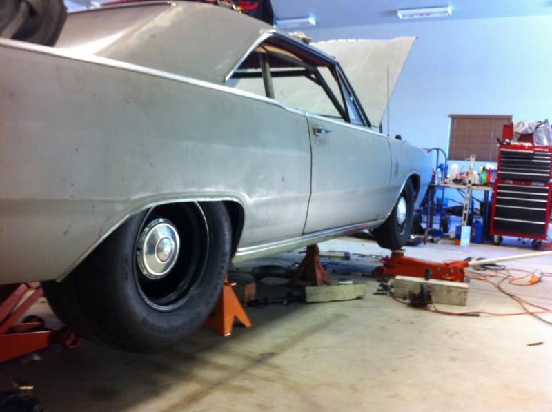

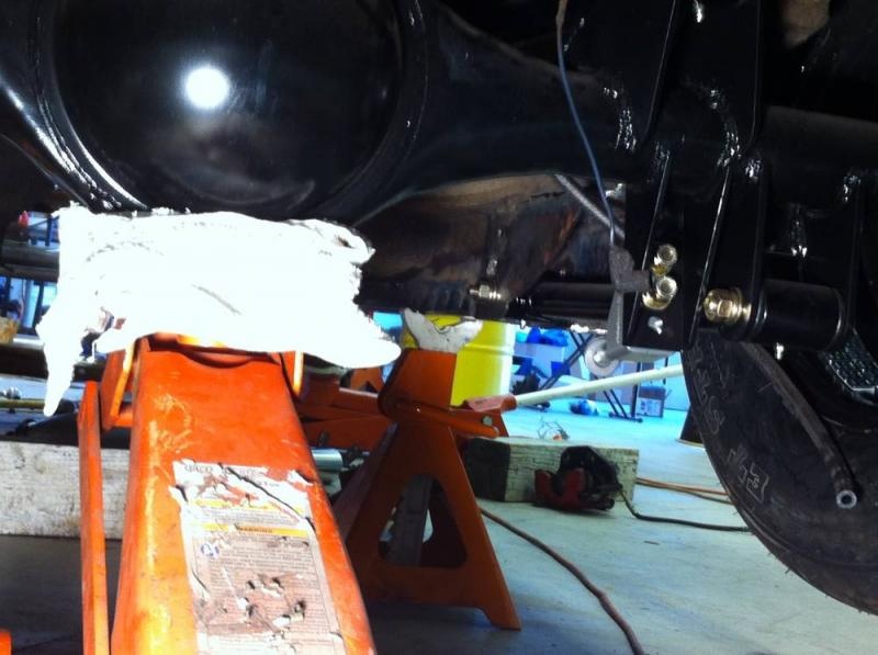

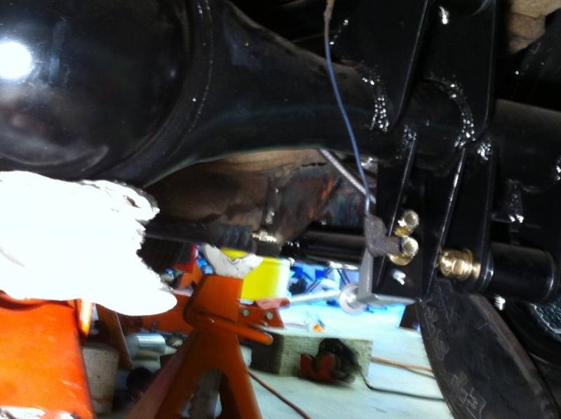

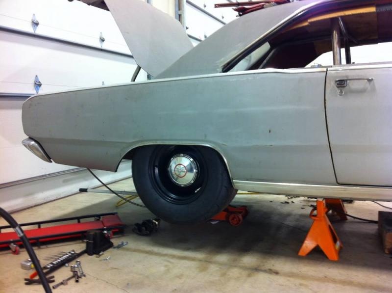

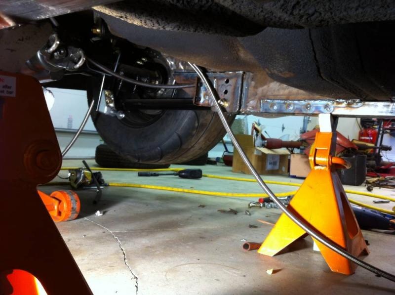

Took some pictures of the ride height today to get my new measurments for the New Upper Link Bars. They will be right at 14" long now and angle from the top of the pumpkin to the side of the frame rail after I reinforce it. The Shock tower will be cut out and moved behind the axle so I can mount the shocks behind the axle. I will again be snapping lines on my shop floor and sealing them with some Clear to calculate Instant center with the help of my buddy Pete.
