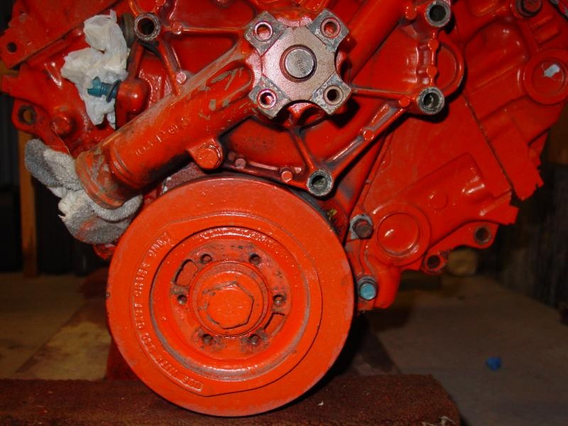

Roger.... many things to do yet before puling the engine! Pull the harmonic damper and take some pix of the front and back side so we can figure out that part of the equation. And pull the bell housing cover and doublecheck that the torque converter is non-weighted. These are easy steps to take before getting too drastic.

Roger, just wanting to be sure. How about the damper? If you have not examined that in detail, you're missing half of the external balance weighting. It is just as important to an external balanced engine as the TC and flexplate. Your description of the damper as having flats on top and bottom is suspicious. Is there anything stopping pulling that part off? SOmeone may be able to ID it form pix and help resolve that.

^^^ 360, I presume....? Who suggested wrong damper in post #2? (Raise your hand, skep419...LOL)
My apologies, if I am not looking at things right... it looks like the cut out part of the ring does not extend nearly as far around as on the one pictured by skep. That would make sense for an external balance 340 vs 360 damper. If indeed the same, then that part looks to be OK... one more thing off your list. But be sure they really are identical.

Your balancer looks like its for a 73 cast crank 340 not a 360. The cast crank 340s are the only ones i have seen that say "For Cast Crank Only" . If you look at the pictures, yours does not have as much offset weight as the 360 one. I don't know how far columbus is from sullivan county, but I have a couple of 360 balancers if you want to borrow one. Let me know and I will PM my phone #.
Ok, I just realized skeps first picture is the one with writing. But yours does not seem to have as much weight.
I measured one of mine , measured like yours in post #68 mine is just under 3/8 . It is 1/2 inch thick. The width of the ring the weight makes on the non weighted side is .300
If that is the same damper it was balanced with,then it should be fine. Now, back to the other end. Does it look like the shop that balanced it made corrections on the flywheel ? I couldn't tell from your picture.

Sam, the OP ID's the flexplate as one of the B&M types that has a notch out of it, and the PN is indeed for a 360. Any weight change at that end would most likely be done at the crank anyway.
