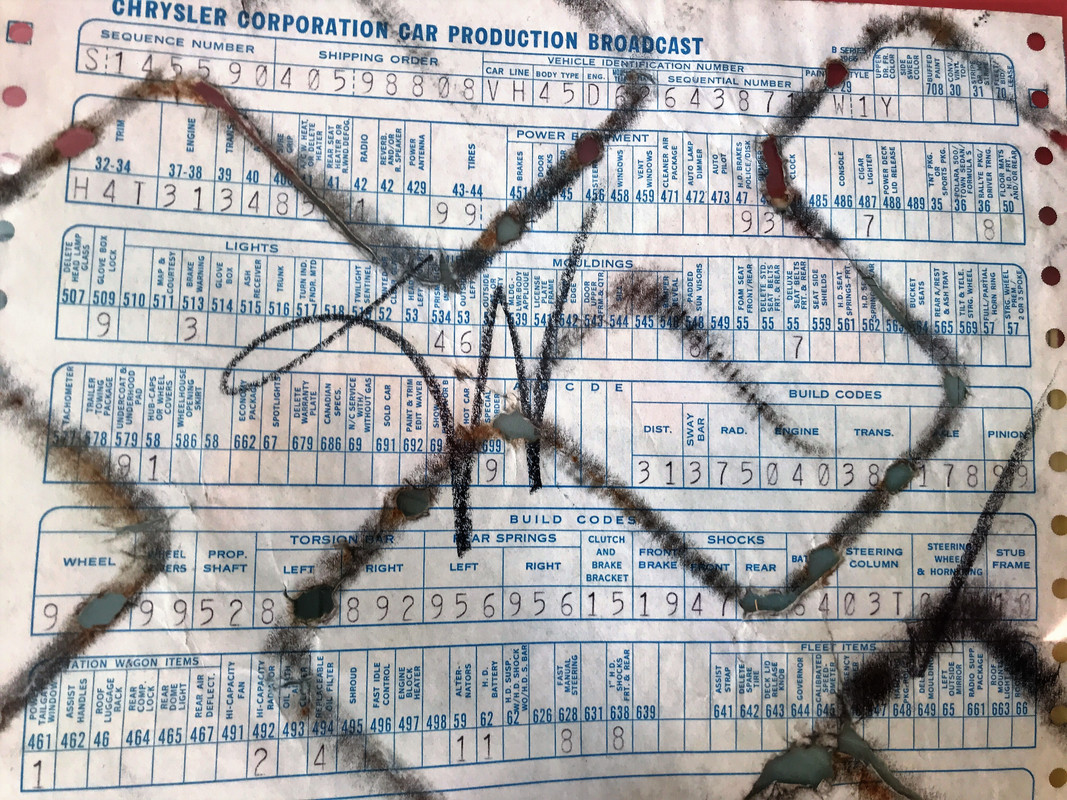

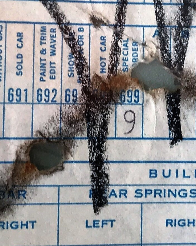

This is a picture of the broadcast sheet of my Valiant - a special order car.
But what is a 'Hot Car' in the column left before 'special order'?
What cars were these 'Hot Cars'?

Just a wild a$$ guess. Probably no air conditioning. Difficult to determine what the complete number is (ie 697? )

Typical for the interweb...but I don't believe it - it is a buildsheet of 1966..
Buildsheets of 1970, when there were truly hot cars, didn't have this column...

Interesting, but 'Hot Car' sounds quite funny for a non-AC car.
And according to this, there would have been very many 'Hot Cars' in 1966...

So what's the actual number on the build sheet and yes there would have been many "Hot Cars" in 1966? :rolleyes:

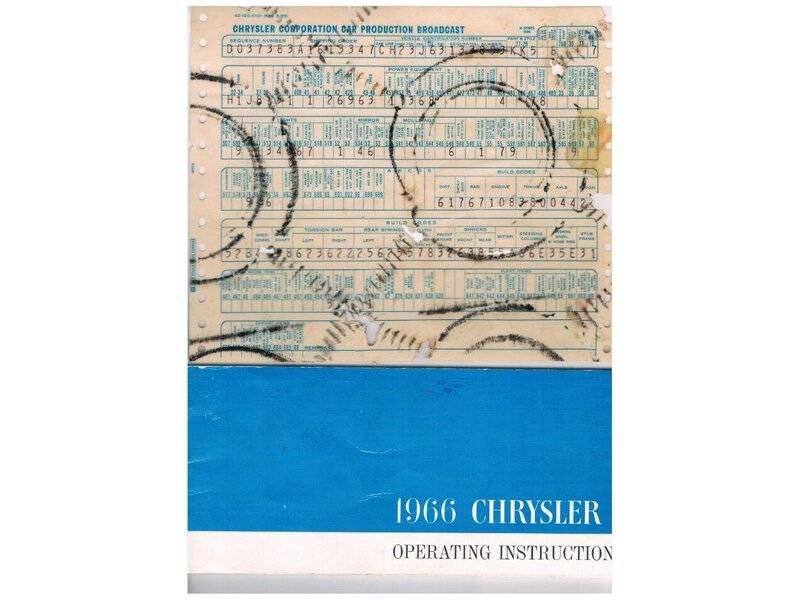

For 1966, 670-699 are Vehicle Sales & Delivery.
696 is New car service with 5 gallons of gas.
690s are all New car something, or special order or sold car, etc.

Thanks and very surprising...'Hot Car' because of a full tank.
They had really humor at Chrysler.
First thought was an abbreviation or something similar to H.D. but those typically have periods.
Here are all the 690 codes.
66 and 68 had 670-699 as Vehicle Sales & Delivery, 67 only 690-699.
Get the IBM Buildcard from Chrysler, the rows on that sometimes have more detail.

look at all the other codes next to it. It is a processing code, probably needs to be built or shipped out in a rush, moved to the front of the line for assembly.
It has nothing to do with heat, A/C or a performance engine.
It's listed right up there^^^^ on that sheet posted plain as day. "696 New car service and 5 gal of gas." That's a hot car.
Interesting. My 1967 sheet doesn't have that box in that location. It has "69 N/C SERVICE WITH/WITHOUT GAS", "691 SOLD CAR", "692 PAINT & TRIM EDIT WAVER", "69 SHOW CAR FINISH A OR B" and "699 SPECIAL ORDER".
''Hot Car'' refers to a car that was stolen off of the production line when it was nearly ready to ship.
Wow, that one rare car! a 273 4 speed station wagon with disc brakes and a 3.23 sure grip and fast ratio manual steering. Probably one of one with those options since they only made 13 V200 273 4speed wagons. That's the rarest '66 Valiant made. That makes it pretty HOT in my book! :thumbsup:
I see it has the suspension package too, which included heavy duty (probably 6 leaf) springs, torsion bars, and a front sway bar.
