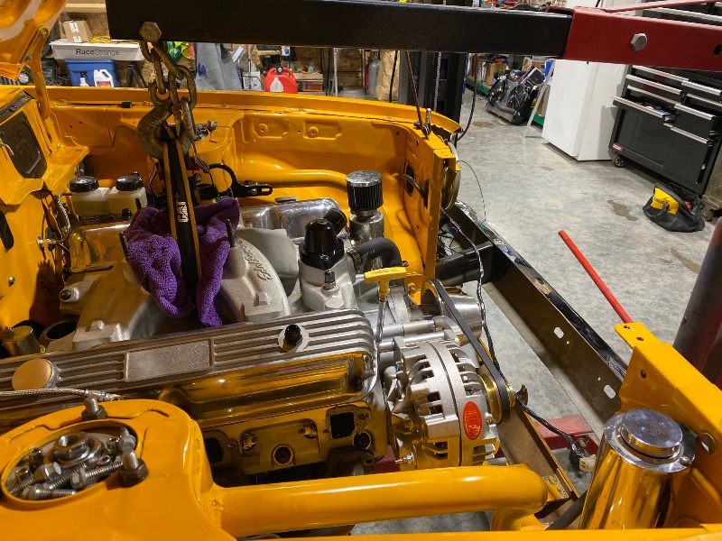

I will not be using the lift. This will be a fairly simple job of plucking just the engine out from the top. I've done this without even taking the hood off.

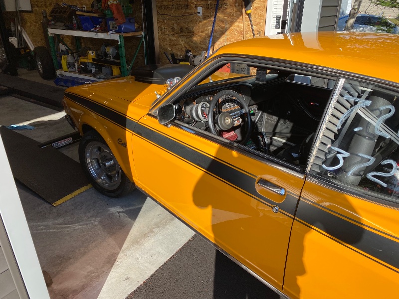

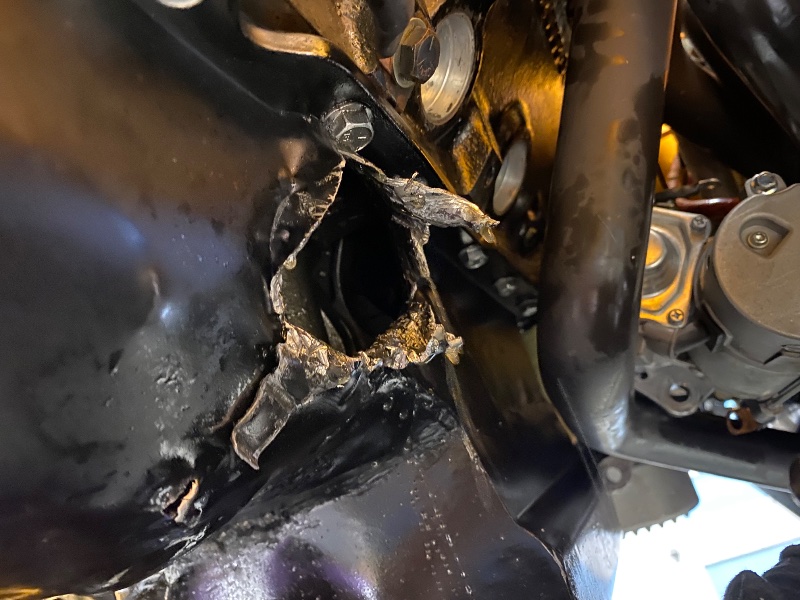

September 13. Threw number 3 rod at drag strip. My friend lives fifteen minutes from the track and he also happens to have a fully dressed 360 magnum to replace my trashed 408 magnum.
Just before 5:00 we are pushing the Colt onto the ramp.
By 9:30 the new engine was in.
We did some odd and ends but a lot of time was spent making a new base pan, the Colt needs a rear sump. We couldn’t find a suitable rear sump so we cut from the mid sump to the back of the factory pan out, turned it around and welded back together.
The next morning we made it back to the track in time for competition. I felt full competition was a but much so opted to just run a couple of test and tune passes.

A 408 in a little Colt? Awesome. Those tires look awful skinny.
Tires are 11.5x26 kinda small but they don’t spin. It’s actually a bit lazy coming out and the car is heavier than you’d think, 3000 lbs with me.
The combination runs 7:12 in 1/8 mile but always seamed to be short on power, I was wanting mid 6’s.
The new 408 will correct some issues. More compression, more cam, better built with a better job balancing the rotating assembly, h beams, oil system mods. Wanna keep them rod bearings happy.
