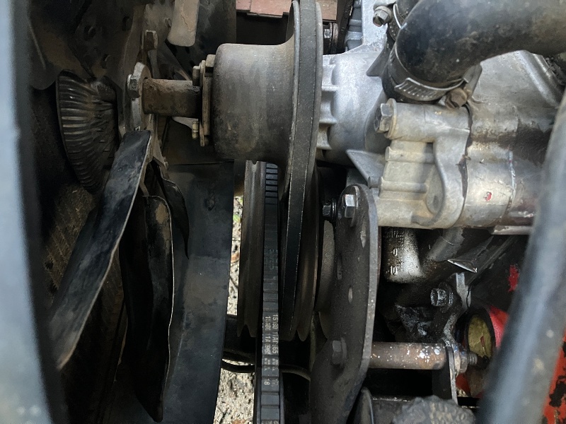

I dug through the stash to find matching pulleys.
The setup on the Dart uses a cheapie 4 groove crank pulley. I used it years ago just because I had it. Belt alignment isn’t perfect but it has never thrown a belt.
The roller 360 will get a 2 groove crank pulley since I had one. I did have to use a 3/16” spacer to get the grooves to line up.
The outer groove is for power steering.

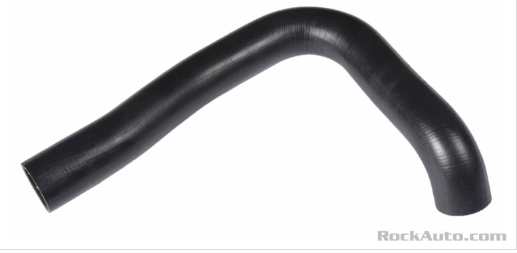

This 26” unit is a 3 core. I’ll need to get that upper hose nipple moved at a radiator shop.
Upper radiator hose opening dont matter what side its on just buy a new hose and run it over to the other side
