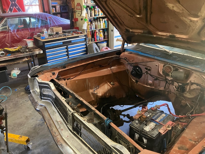

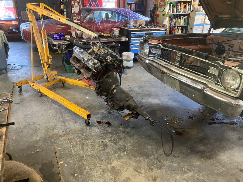

Yesterday, Rich and I got to it about 10:00. The plan changed a bit. Originally, I wanted to leave the transmission in place and just pluck the '76 360 out as complete as possible, slip the '90 360 in place, swap over any parts that I intend to reuse and fire it up.
Of course.... that sounds easy. In theory, it could have gone that way.
Instead though, I decided to pull the engine with the transmission together based on the assumption that it would be easier. You see, access to the bolts from the bellhousing to engine is not great. Add to that, spool engine mounts make it harder to mate an engine to a stationary transmission.
I'm glad that I revised my plan. It did work out better. The hood even stayed in place. By 4:45 yesterday, the '76 360 & 904 were out, the transmission was scrubbed of all the dirt, oil, ATF and grime. The '90 360 was prepped and the 904 bolted up, then set in the car. The garage floor was cleaned with degreaser, the starter was scrubbed of oil and grime, the tools were cleaned and put away. I installed the '76 360 over 20 years ago. I did it on a budget so some corners were cut. I've been off road, on trails, through creeks, wide open fields, on the road and it never failed me. As we got into the project, I started laughing at some of the Roadkill butchery that I had done. Junkyard exhaust system with Flowmaster mufflers that were picked from a dumpster...the baffles were rusted out and I just patched them up...single chamber flowmonsters! The left hand motor mount was missing one bolt and nut, one bolt was missing a nut and the only one with a bolt and nut was loose. The harmonic balancer bolt is supposed to be torqued to 100 ft lbs. This one was finger tight, maybe 1 ft lbs actually....

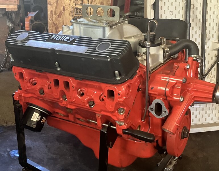

The 1990 360:

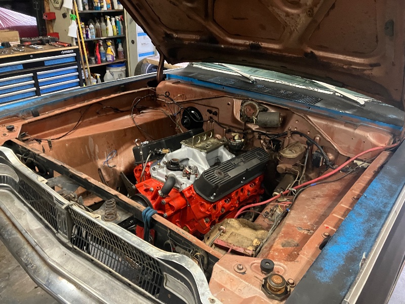

Rich and I got the Doug’s headers in a lot quicker than expected. The car was on jackstands so high, it did not inspire confidence but I was the man underneath since it is my car. With a floor jack under the oil pan, the engine was lifted and shifted to the right and the header slipped right in. 20 minutes, maybe? The right side was 5 minutes at the most. The center link was unbolted for a clear path.
While the engine is in now, there are some small details to tend to. I need to get the right grommets to allow for a PCV and breather. I need a thermostat and the tailpipes are due in tomorrow. I'm thinking of ditching the points ignition too. I have several underhood wire harnesses I can use to install a stock electronic ignition setup.
