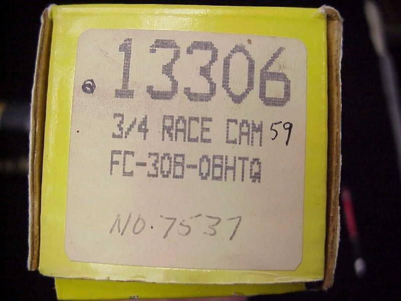

Hey Mike, I will sell you a 3/4 RACE cam !! man it is special !:lol:
That's what everybody needs.
Well its only a 274/283 at 0.050" so for what I normally make yes its a 3/4 race cam. HA HA HA
"3/4 and full race" was back in the day where a 300°/.500 was pretty racy.
