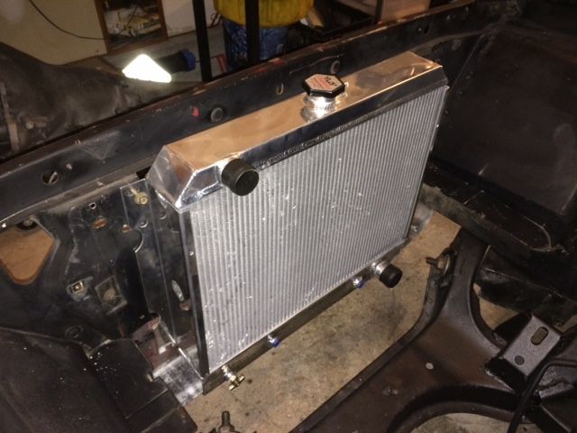

I just put this one in my Dart last week. The mounting bracket was bent a little, but I straightened it out myself, and I had to drill a mounting hole in one of the brackets. Other than that it it appears to be a decent radiator. None of the crappy welds that some have complained about?
