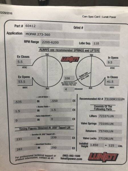

Got a 408 a 3350# Duster, estimate 450-475hp. This is a street only car--4spd, 3:23 gears with 245/60-15 BF Goodrich's. I got a Holley sniper so can look at datalogs. If I am in first gear rolling along at about 2000rpm and mash it, it takes about 1.75 seconds to get to 6000rpm. Only traction addition is the pinion snubber, but seems like it hooks up, tires aren't squealing or leaving black marks . Just seems to me it should be quicker or am I expecting to much?
Sniper with WOT a/f at 12.8, Edelbrock rpm heads & intake. 235/239 @ .050, 535/550 lift. 9.5 compression

While I would tend to agree with a dcr under 8:1 being a turd at low rpm you made a huge assumption on Intake closing degree not knowing the actual spec. That could be the difference between a 7.2 and an 8
OP gave us all the info we need, namely 235* cam and 9.5Scr. I wikied the elevation, and got 1900ft.
The advertised on a FTH 235@.050 cam is gonna fall into a very small slot of plus/minus 2 or 3 degrees, say ramps of 42 to 47 degrees. This makes the 235 to be about 277 to 282. I chose a 284, cuz that's a typical off-the-shelf cam in this range.
I installed it at 110, which takes the guess-work out of the LSA. That makes the Ica to be
180less {[(284/2)-110]+360}-284=72*....... At whatever, tappet-lift. Could be .008 with a Mopar/ Engle/ Hughes; or could be .006 with others. No big deal, to prove my point.
The next smaller cam will only change the Ica ~3.5*, and maybe 5 to 7psi, so not enough to create a big change in proving my point.

Cam card below. Elevation here is about 900ft. I’m going to Hang a GoPro and see if tires are spinning, but it makes sense that they are...6k comes out to 56 mph and I’m not doing 20 mph to that in 2 seconds. Maybe it’s doing more that I think it is, especially with the 3:23’s. I got a 100+ mile cruise this weekend. Maybe after that I’ll put the 3:73’s in and see how it feels.

2800 stall is the tire smoker...but what are your camshaft specs?
It's the 380hp/360 crate engine, think the cam is 288/292 230/234 @ .050" .501"/.513" 108
