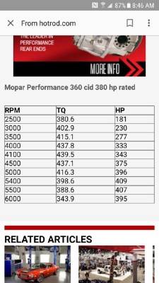

Here’s the rated 380hp 5.9l making 409 hp

The 380 crate motors put 3,200-3,300 pound a-bodies into the 11.80-11.90 consistently and some 11.50. With no spray add nos and maybe drop a second?
