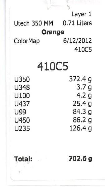

@abodyjoe
Joe had some paint mixed up from Upol??? Had a thread. I used it on one engine as well. looked good, lost can and contact info along with the formula.
Depending on the paint brand, Chevy orange is almost exactly the same as Chrysler orange. Remember that it is paint and with paint, prep is everything.
if you want the accepted most "correct" then use the stuff from Bill Hirsch...
if you are using spray cans then they are all over the place color wise. even tho mopar performance stuff isn't the correct color...
i use a high solids paint over epoxy primer applied with a paint gun and it not only looks great it holds up incredibly well...
