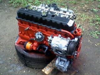

a couple pics of one of my 96 4.0 litre HO jeep engines. great motors, i have seen them go 350,000 plus miles. they are TALL motors. you would need the entire engine harness, the computer and engine management systems and you would have to work the AW4 trans in there which is also a large trans. im sure it can be done, though ive never seen a swap into an A body
