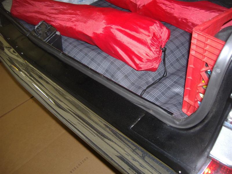

Ok, I've been looking for replacement weatherstripping for my Barracuda. My original weatherstripping wrapped around the edges on the top and side, but transitioned over to be glued flat at the bottom. See the attached picture. Everyone seems to be selling the later style weatherstrip that just glues to the top of the pinchweld. Can anyone provide an accurate picture of the "correct" seal I'm looking for, and better yet, maybe a profile picture if the edge is coming up. Unfortuately for me, the original seal was discarded when it went to the body shop. I figured I could easily get the right one since I have seen the same style on other Barracuda's, C bodies, and B bodies. From what I can tell, it looks roundish on the top- nothing sticking up. Any discussion and/or images would be greatly appreciated.

Here's mine. Got it from Laysons back in 2006.
Their part number was SO-CH1004 for a fastback
I'm very satisfied with it...I assume it's correct.

Maybe I should be more clear. My original one was glued to the top, but it was either split, or it had a piece that wrapped around the edge of the pinchweld and was on the bottom. Kind of like our window seals- slid on the pinchweld. I know that because my car was originally white and when we painted it the first time, we just taped off the original seal... well, now that I removed the original seal, I had the white paint still on the top as well as the bottom of that pinchweld. Everything else was the new color.
Fast forward to today- I removed the old seal and somehow accidently threw it away. Now I can't find one like my original seal- one that wraps over the pinchweld INSTEAD of just glueing to the top. Let me see if a picture will help.

I'm starting to believe that maybe the original seal was installed differently than just being glued to the surface of the pinchweld. If the original seal is a K shape, maybe it was glued with the bottom of the K extending down below the lip. Either that or they switched seal suppliers mid year or so since I have seen several 68 chargers with the seal extended around the pinchweld like mine was. I was even wondering if by chance there was a trunk leak problem that the dealer may have fixed with another style seal. Only thing is that the seam is where it was suppose to be and the glue had never been disturbed. (see 1st picture in this string- it shows the seal before being removed.)
