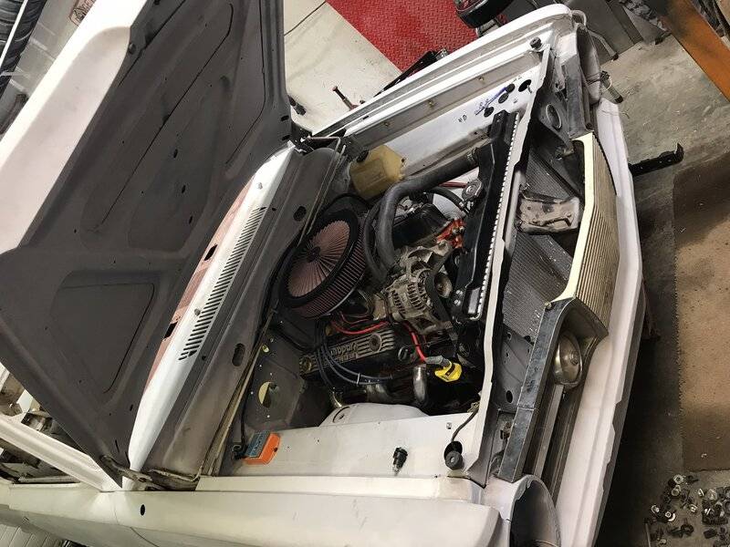

I put the box on the driver's side inner fender of my 65 Barracuda, mostly because that's where the then new early seventies A bodies put them. Been in the same spot since 73. Not necessary to get an engine wiring harness specifically for electronic ignition. I just got a separate electronic ignition harness, routed it through the factory clips, but did not try to integrate it into the standard engine harness.

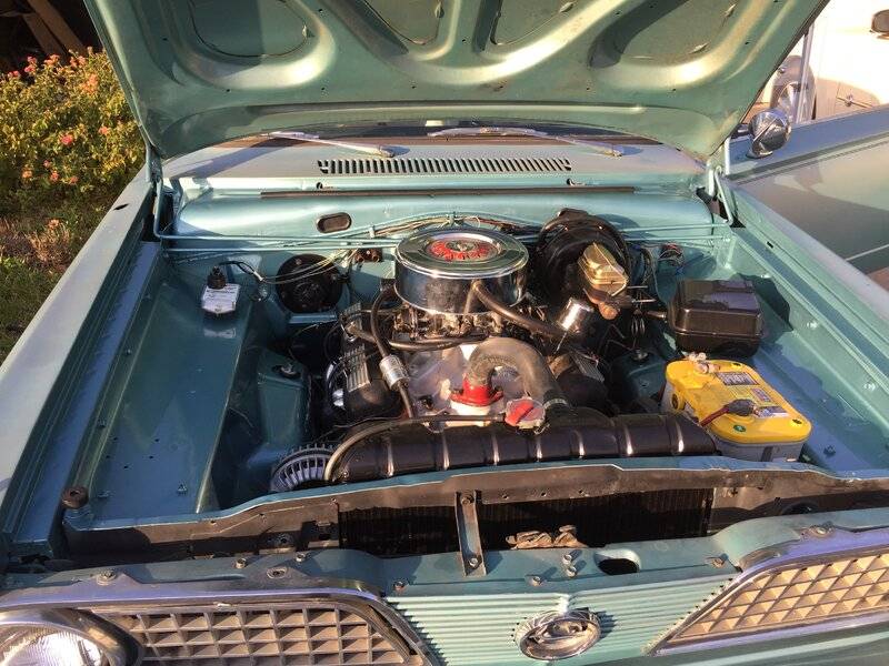

I put the box on the passenger side inner fender of my 63 Valiant because that's the side my slant 6's distributor is on.
