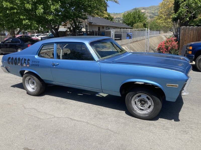

Do the Duster….leave the Nova…that's the truth, big blocks have been a pain to put in, been there and done that with some friends cars. I just sold all by small block stuff, so I'm not sure if I did want to do an of those an more. Being old and chonkers and trying to reach the distributor in the back with a bad back, bad leg, bad shoulder, bad breath, not sure it would be good for me anyway. Though this 73' he has does make me want to build a track car.

That's a Chevy duster.... jeez lolDo the Duster….leave the Nova…
