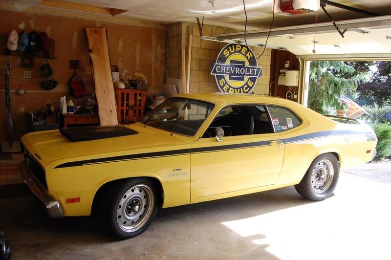

I like the Duplicolor Silver Wheel Paint.
Its available at auto parts stores nation wide.
Its durable....and affordable to touch up later....and (as far as I know) its the only "Argent" colored silver Duplicolor there is on the shelf at an Advance Auto Parts Store....its usually kinda $$ but (1) can will go
A L O N G WAY.
my .02
1...maybe 2....I dont remember...I bought 3 or 4 cans a while back...and if I remember correctly it took me a full can to coat the faces of all 4 rims.
dwire67 , I have been wanting to do this same thing to my Daughters D.D. !!!!! THANK YOU...THANK YOU...THANK YOU ! Your Car looks GREAT ! I do have the small bolt pattern on Her '65 Barracuda to deal with but I can see it and how it LOOKS and it looks Great on your Car.:cheers: (I hope you don't mind if I steal your Idea. I can call it information sharing how about that.)
THANKS, TIM
