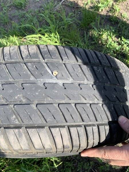

Went on a 1000 mile road trip and blew a tire 50 miles in. Contemplating running the same size so I can have a spare that works everywhere.

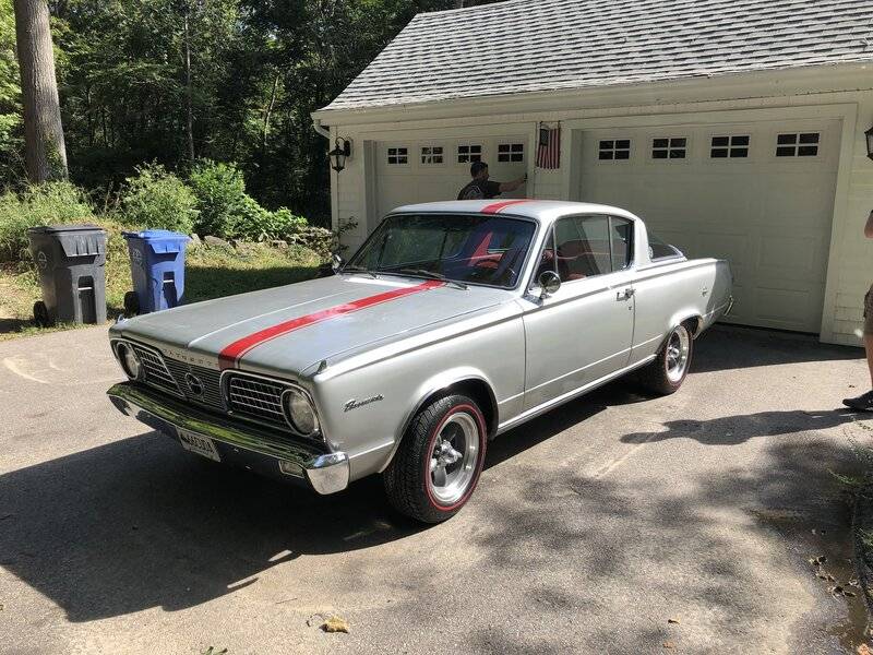

67 Barracuda. 215/70-14 on 14x5.5 rally wheels.
Considering that this size won't fit in the spare well (I have a 185/70-14 in there), and that I have an SG rear axle that can't handle mismatched sizes, it's critical that I have the ability to swap tires front and rear in an emergency. I'm not one of those people that calls for a tow every time there's a problem. I like to be self-reliant, and I often drive in areas with no cell service.

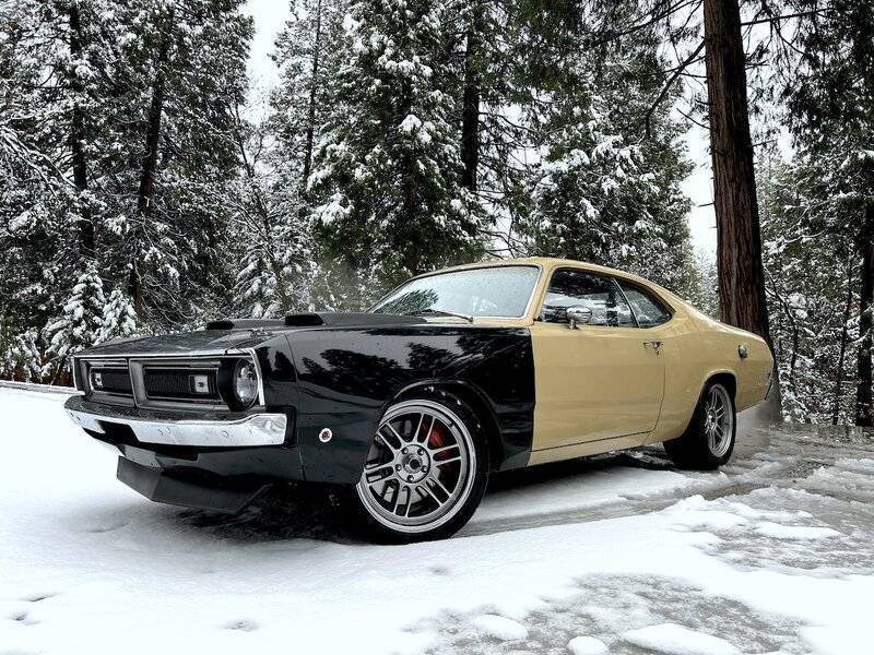

I ran 225/60/15's on all 4 corners of my Duster for awhile with cop wheels, 15x7 with a 4.25" backspace. Now staggered with 275/35/18's on 18x9's in the front with 295/40/18's in the back on 18x10's.

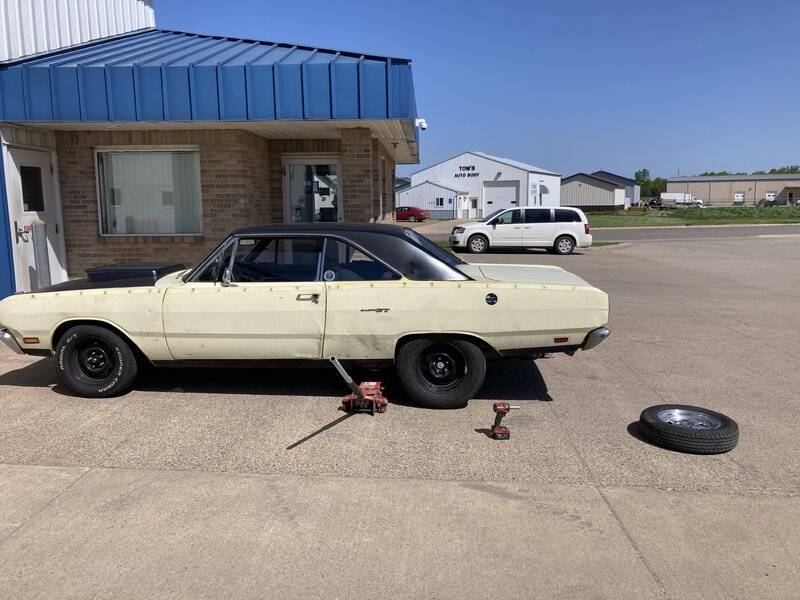

1969 Dart
It would be nice (something I didn't take into consideration until mentioned here)

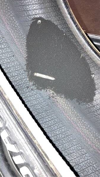

I ran over a valve stem (with the core removed) while passing someone, it was flat by the time I got back into the right lane.
