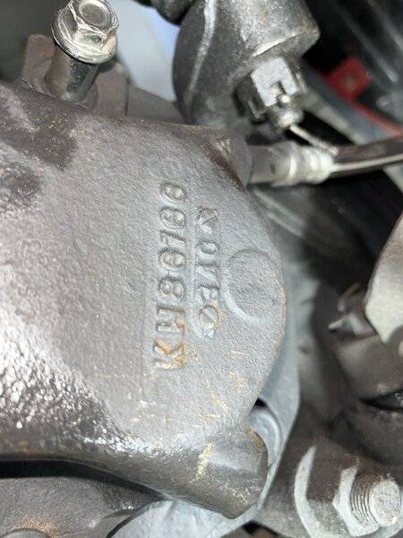

Here's a pic of the caliper. KH86166 is the casting number and they were used on 70-72 B bodies and 70-74 E bodies.
Correct, I think. E bodies kept the pin style calipers for the whole run, '70-74. I'm not entirely sure when the B bodies changed over to sliders, by the parts catalog it looks like '73 was pin type and '74 was sliders but knowing Mopar there was probably some changeover period.
That would be '70-2 E-bodies. '73-4 used the same brakes as an A-body those years. .
Nope. E-bodies were pin style calipers for the whole run. The spindles changed in '73 but E's kept the pin type calipers. You can check the cross references, look at the brake hoses which are different for the pin style calipers, etc. Or look at the '73 mopar parts catalog. The "V, L" line was A-bodies.

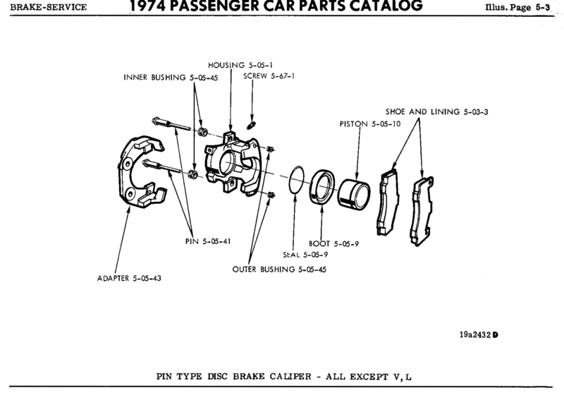

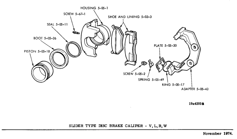

The '74 parts catalog added sliders for the R, W lines, so, '74 lists sliders for A and B bodies. And it specially calls out pin type and slider calipers.
Funny, it lists V, L, R & W as having sliders in one picture
And the next shows pin style all except V & L......
Yeah that’s the ‘74 catalog. It’s literally the same page, I broke it up so it would be legible but those illustrations are right on top of each other. I’d say it was a carryover from the ‘73 catalog and then they changed the slider illustration but the text is different from ‘73 on both illustrations. So B bodies are a bit of a question mark. They definitely switched to sliders at some point in there but my B body is a ‘71 and I don’t know much about the 73+ B’s.
