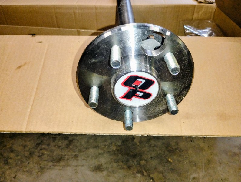

Getting the 9" rear end ready. Got my Track Lock installed and the backlash reset. Got my custom axles ordered from Dr Diff today. I put 8 3/4 - Dana 60 housing ends on it so I can keep A body brakes and small bolt pattern. So the axles will be A body SBP on the flange end and Ford 9" 31 spline on the carrier side. Yeah, it's overkill for a slant 6 maybe but I still will have less than 800 bucks in it. Lets see that done with an 8 3/4. Ain't happenin. With the 4.11 gear, it should be a lot of fun after I get the T5 five speed swapped in.
...............A red rear axle...........sigh...........
As the internet says, "watch to the end..........."
All I can say is, if any of yall have the chance to work with Cass Eslick at Dr. Diff, do it. I was sweatin bullets that I measured this thing right, but Cass made SURE we double and triple checked before I pulled the trigger. I "JUST BET" this is the only 5x4 small bolt pattern Ford 9" with Chrysler ends and brakes on it. But here it is. I'm gonna get the drums cleaned up good and painted nice so it'll at least look somewhat good. But Cass is DA MAN! All this just slid together like hot butter. Cass, I cannot thank you enough.
