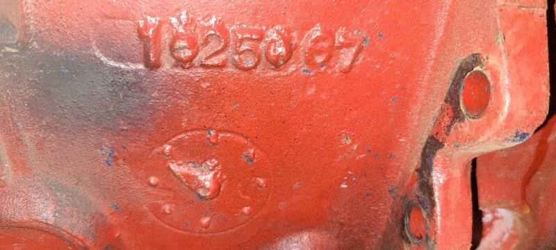

Well...I went out and pulled the heads and here's what I found...2 barrel pistons, not 4 barrel High compression. not what I thought I was purchasing 3 years ago...but it did run strong. Any thoughts?

That's what I thought you'd find. It depends how far you want to go with it. If it needs bored and you need pistons anyway you might as well get the high compressions ones. Egge still makes them. What rocker arms do you have? Adjustables? If so you can change to a solid lifter cam like the original engines had with new lifters and pushrods. But, nothing wrong with a hydraulic and lots more choices.
yup. 67 model year 273 with the old 65 heads, probably wrecked the old block and got another later model and moved everything over. Valve job, get a cam to match those lower compression pistons and run it. @AJ/FormS could probably tell you what grind to get to maximize your current mill.
The Commando 4bbl block is the same as the 2 bbl, only the pistons differ, so other than the casting# being the wrong year, your block is "correct" for a Commando. 4bbl cars had a special exhaust with rear resonator. It is still a single exhaust, but the rear valance has a rectangular slot (driver's side) to clear the resonator, so if your body has that it was an original 4 bbl car. I don't recall if all 4 bbl or a special model (D-Dart, HiPo, forget). A member here in Europe has one and has posted all the info.
