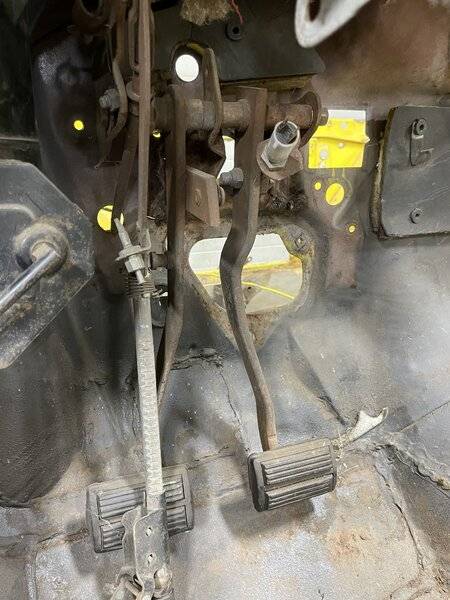

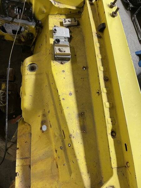

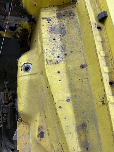

I have a few questions I need help with before it goes to paint get blasted. Can anyone help me with the driver side apron pics. Mine has holes everywhere and I can’t find what goes there factory and would like to weld up what holes aren’t going to be used before I put it in primer. Also it was an auto car I think but it has 4sp pedals in it. My dad has a 4sp and bell housing he said I can have or would it be easier to keep it auto? Someone did a crappy job I think trying to convert it lol.
Google up some images of "1967 Dart engine bay" and you'll get a lot of pics to help.
But remember, those electronic ignition components in your pic weren't stock '67- so look for some pics from later model Darts to assist with locating them in your car, if you retain them. Basically all you had on the left fender apron from the factory is the washer bottle, holes for wiring harness straps, battery tray and hold downs, and the fender tag.
Welcome from Michigan the Motor City! Looks like a solid start. Don't get discouraged, restoring a car is a time consuming task. You will learn a ton and develop skills that will forever be to your benefit. 65'
As expected, your 50yr old car has had modifications for unknown reasons. When building a car it is best to have a clear vision of what you want to end up with. Will it be a restoration, a cruiser, a hot rod, or something in between? Build it your way, have fun, but have your end goal in mind. The extra holes in your inner fender are for mounting the ignition resistor, voltage regulator and ignition ECU. These were upgrades added later and are not original the car originally. Your choice what to do with them. The holes for the original components are in the firewall. However two holes would originally be there to mount the windshield washer bottle.
I love Plumb Crazy!! looks like it will be a cool build...........but is that a Jeep Commando in the background???
None of the 3 electrical items in your photos, on the left fender apron, were factory. Don't get me wrong--if you are going to use factory breakerless ignition, and the later alternator / regulator (70/ later) then you will need to keep them. But there were no factory holes. The regulator and 2 terminal coil ballast originally went on the firewall.

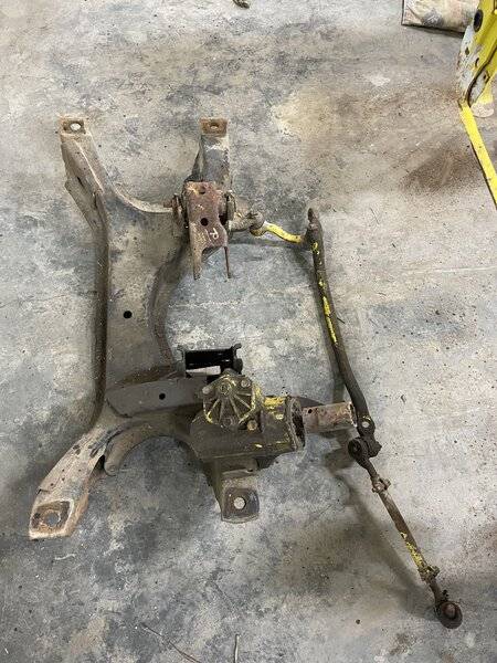

If you have the original front crossmember "K member" that is a one year only idler arm and they are getting harder or at least more expensive to find. There are a couple/ three ways to deal with that.

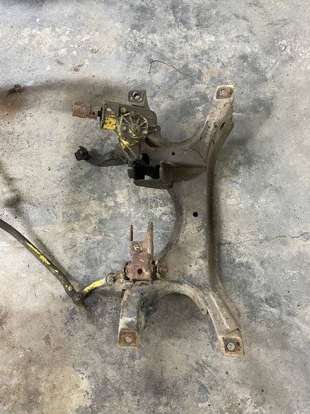

what are the options for the k member? I have one but how do I tell if it’s v8 member ? Also I was told I can swap grills and taillights ?? Thought 67-69 where all the same ? It’s not going to be original a hot rod for sure. Can you use the 68-69 with modifications or is it better to find 67?
Folks have done modifications to use later grills, you must remove the headlight buckets and move them (drill/ grind out the spot welds), for tail lights modify the openings in the quarters, the K members you have several options
If you need to change it because you are say, going from 6 to V8, you can use either 68--72, or 73/ later
68-72 uses the same "pillow" engine mounts as 67, and the only real difference is the 68-72 idler arm is way more available The mounting bracket is different. You could also modify the 67 K to tak the 68/ later idler arm, but you need to find an example K member and build a "jig" to properly locate it
For the steering, you have a "break" at 72-73. You must group 68-72 together and use the matching center link, idler arm, and pitman arm to fit the steering box. The power steering box pitman arm shaft changed spline sizes 73/ later That is, those four parts must all fit.
Or you can do the same thing and use those 4 parts grouped in the 73/ later group. Either group will fit either K member that is, 68-72 or 73 to 76.
73 and later K members used "spool" engine mounts. Some guys think they are better, some thing they are worse.

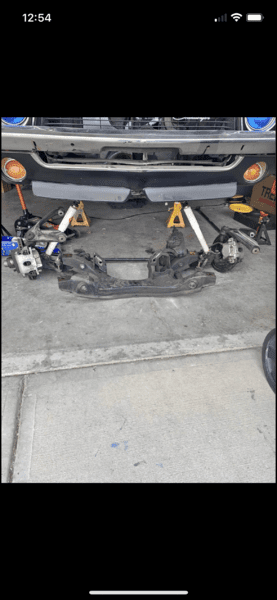

Hey guys can someone help me with this I found a front end out of a 70 e body with brakes and control arms. I need this stuff for my project will this stuff bolt to my 67 crossmember ? It has disc brakes and everything. I’m assuming tie crossmember won’t work.
The only thing you might be able to use are the spindles, calipers and rotors. None of the other stuff will work on an A body.
You will need to locate a set of '73 and newer A body "big ball joint" upper control arms to use those spindles, your existing lower control arms will work.
Lots of good info on brake parts interchangeability in the bigblockdart.com tech archive.
Tech Index (archive.org)

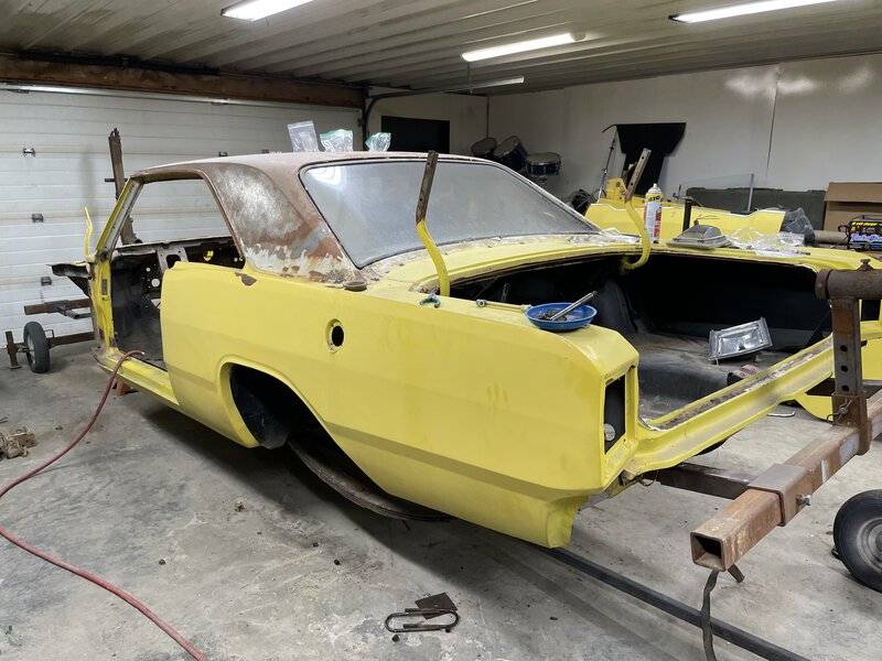

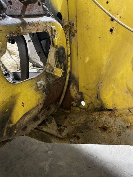

Making progress. Got it on the rotisserie last night. Found some real bad body work but we will fix it. Still deciding if going 4sp or automatic
