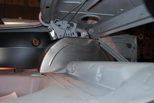

Looks real nice...got to get those wheel tubs in.....get the flat top ones, they look more "factory-ish".

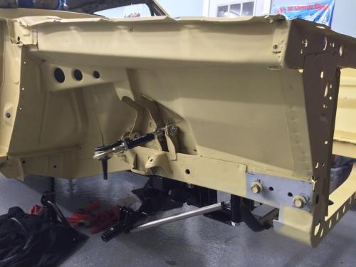

Took a night and got a bunch of the front suspension together!! :burnout:
Started with the K frame.. The only thing with that is the bolts that came with it did not come with washers so I needed to search for some that would work temporarily.
The rest went in all trouble free except the washers for the strut rods that are supposed to sit in the k frame outlet were to big for the hole so I needed to grind the washers to fit.
Overall everything fit very nicely.
I did find out I needed to order a few more things though like a Bolt kit for the Lower Ball Joints.
Lower ball joints themselves and torsion bar boots and clips also I started putting together on side of the brakes but soon found out that I needed a 3/4 inch nut and washer to hold the hub on the spindle .. So a few small roadblocks but the quality on these parts are nothing short of amazing :prayer:

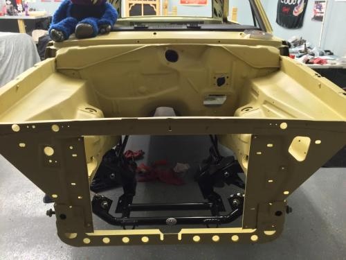

Just came back in (2:00am) from the garage and I am happy with what I got done!
I thought before that I had the caliper mount brackets on backward but after putting them on the side witch I thought was the right side that really confirmed that I was right the first time.
So I switched the bracket back around and it was still giving me the same problem as before because one bolt would go in fine but the other wouldn't... Like it couldn't reach the hole.. almost like the bracket is to short.
I ended up having to hone out one of the caliper mounting holes on the caliper with a file so that the bolt would reach and finally after messing with that I finally got it in. Doing it yourself I would recommend using a lug nut or two on the studs to hold the rotor on while you are putting on the caliper, otherwise it is a pain unless you have someone there to lend a hand. The only thing not tight on the drivers side is the lower ball joint bolts that go to the spindle just because I didn't want to wake my mom up with the impact.
I only have one complaint on the spindles and that is ,is that the bolt holes for the caliper mounting bracket have some powder coat in them from the power coating of the spindle so I spent like 10 minutes on each spindle cleaning some of the power coat of to allow me to run a bolt through.
I was all confused when going to put the hub together with the grease seal and bearings. I ended up having to call my dad and keep sending him pictures until we figured it out that I put the studs in backward so that Is why nothing would fit right... (hey, it was late okay!)
Once I got through that, that side went together flawlessly and I didn't even need to end up filing another hole.. To close it all off I Put one side of both of the PST tie rod ends and sleeves assembly together so they are just sitting there.
All that is left to do to the frontend is to put the pitman arm on, center link, tighten everything down and then on to the bigger stuff like wheels and tires and even a steering box and steering column. :burnout:

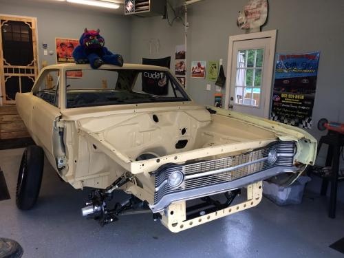

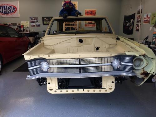

Got some more done today..
I got the PST inner and outer tie rod ends on and the nice heavy duty adjusting sleeve.
I went with 11/16 Tie Rod Ends as a upgrade to the regular I think (9/16) ends. Good upgrade to make. I also got the center link on and everything all hooked up and ready to go.

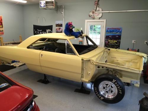

I set on one of our drag tires on the car (28 inch) just to see it on there.. I will probably be going with 26". I also found a grille laying around so I had to set it on there just to see it.. :burnout: getting closer by the minute
