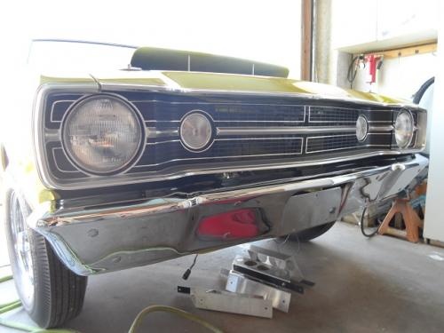

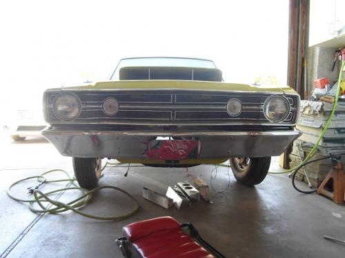

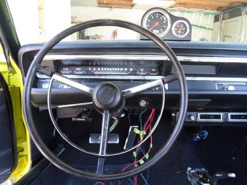

I am pleased to present and report on lots of progress since February of this year! I sold my 1991 Mustang which afforded me funds to complete all of the chrome, complete the interior (not pictured; seats should be done in the next week), finish restoring the front grill, finish the trunk, purchase the A/C components, etc.. The 440 is progressing as well courtesy of Dad at SS&AFX. The Dart should be up and operational within the next few months :-)! I've got a 2014 NHRA rule book on the way to make sure the car is compliant with the latest regulations for bracket racing. Anyway, I hope you enjoy the pictures and progress, I am really excited at this point. I can practically smell the race fuel :-)

Just washed her up today. Still 100+ degrees her in sunny Arizona so I have taken hiatus of any major work since last post. Seats are now installed and look great, 440 block is back from Chuck's speed center after all machining and balancing and I completed all deburring! Nasty casting flash! It will be sent back to have .020 shaved off the deck based on piston to deck height measurements and then clean up and assembly of the short block may begin. I will post pictures as the build progresses. I purchased a good used set of TTI long tubes off ebay about a month back for under $350.00 shipped. Some minor repair on a couple the 2" primaries and fresh ceramic coating and they will be as good as new! I cannot wait for the weather to get better soon and finish up wiring the MSD, battery cables, etc...
