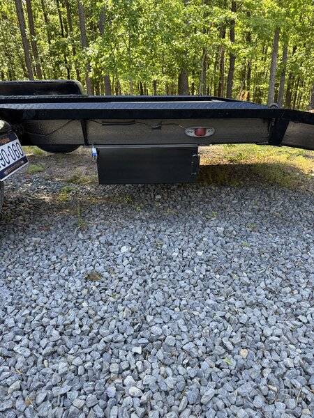

This is the original racecar trailer my FIL built, and surprisingly, there was no storage for ramps. I did get some storage for the ramps completed. I think it turned out great. I had a local guy fab it for me, he did an outstanding job...........

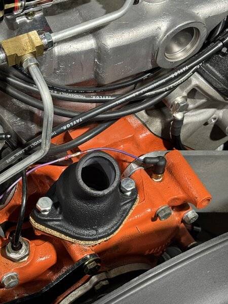

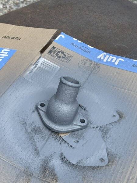

The chrome thermostat housing was leaking. After trying to fix it with some gasket sealant, it still wasn't good and looked terrible.
I went through my old parts and retrieved the original cast-iron one that was on the car. Hit it with the bead blaster, high heat primer, and high heat paint, new gasket, and no leaks. Plus, I think it looks better. :thumbsup:

You can't go wrong with the stock one. Those chrome ones usually leak.
