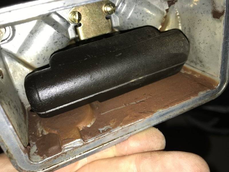

Another problem of this car is rust in the tank. I cut the fuel filter open and was amazed, it was half way full of rust. Now I do carb tuning with fuel from bottle until we clean the tank and put new fuel lines on it.
Please find photo of rear carb bowl after 3 days of playing with the carb. It was cleaned before install.
I will finish with initial carb tuning today if all goes as planned.
Need to work on jetting under load after we deal with the rust.
So far I have 4.5 pw, 64 jets in the front and 72 jest in the rear. Need to get smaller squirter for the rear...
Everybody that targeted the carb were right, but this car was neglected over longer time and now needs moren than expected. Whatever I touch needs some work...
