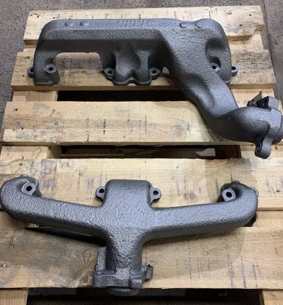

I told him to check the flange orientation back in post #2. all 273 early A manifolds point back...
67s started to point down
340's point slightly forward and have larger ports.
You may end up getting away with just a clean up and a proper gasket orientation. It looks like you got plenty of surface there. Your post 9 pic and my post 4 pic look about the same. By opening up your port, your going to exceed the gasket profile and that will not help. Just try the (new) gasket the correct position and it should seal right up.
Chit if I know man. Since you've not bothered to post a picture of the offending manifold, I don't even know why I'm trying to help. You think you might can do that? The WHOLE manifold? Then the offending port. A casting number and date code.

That appears to be the correct mannyfold. Can you post a pic of the offending port?
Yeah, It Shows That The Flipped Gasket was the Issue...
I'm tending to agree! @Max1196 nailed it in post #3. I also wouldn't recommend assembly without gaskets. A lot of Chryslers didn't use exhaust gaskets from the factory, but they were assembled with brand new parts with no pitting from rust or warping from heat. I would use the manifold gaskets. That said, I prefer the one piece kind, if you can find them.

you have another option. Get a port flange like 1/8 thick and mill that portion down 1/8. Bolt that between the manifold and the head to give you another mounting surface. hit that area with a stone and get it flat so you can see where the low spots are. Ultra copper RTV works on exhaust flanges. I think you got enough to seal with only the manifold. dab some paint (zinc oxide) on a manifold and put it on and see where the paint hits.

The early 273 manifolds will hit on later heads causing #7 to leak. The long outlet hits the leveling boss on the edge of the cylinder head down by the lower right hand head bolt. This keeps the port from sealing. And cranking down on the bolts will just break the manifold. Not saying this was a factor in your situation, but it's worth checking.
And whatever you do, don't try to grind the extended port flange on #7 to get clearance, there's a water jacket right under the surface. I trashed a perfectly good 308 head that way. The only safe way I've found to do it is to mount a bare header flange as a spacer between the manifold and the head.
FWIW, I've run into this same type of interference with left side early 340 manifolds on Magnum heads, too.
