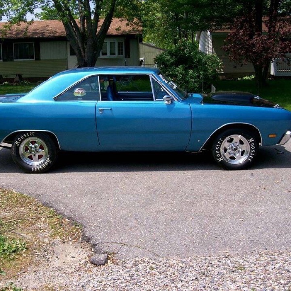

Originally a 273 ‘69 Dart, has a little more than that now, and running low 11’s.
I think that’s where I’m at with this
