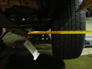

315x60x15's on my 64 Dart GT
I've got 30 x 10.5 x 15 inch Goodyear slicks mounted on Vintage Cragar Supertricks on mine. Since I have Superstock A990 springs, they fit pretty well except for the front of the rear wheel opening. When the slicks grow they rubbed. At some point the wheel opening there was hammered flat. (Ahhhh... the joys of old race cars) My only problem is that my wheel openings were stretched sometime in the early '70s or so, and the welds started to go. I'm in the middle of repairing the openings now.

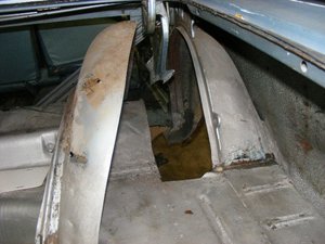

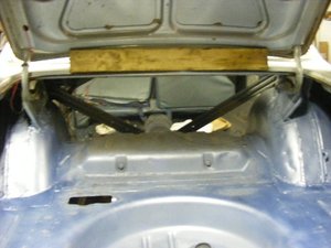

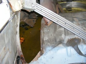

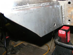

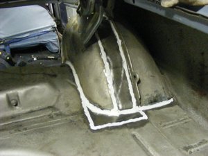

So, I spent the better part of the past 2 days working on the mini-tubs on the 64 Dart.
Here is a shot of the drivers side. You can see that I had to move the trunk support higher up on the wheel well. You can also see the original holes where we drilled out the spot welds. I have one more small patch of rust that I need to cut out, and then weld in the final filler panel. This was the first side I did, and I definitely learned from this side...the other side turned out better.
Here is a shot of the passenger side. I had to make a large filler panel, and then weld in the patch panel. You can see that I needed to weld in piece of metal that runs the full length of the area that supports the upper shock mount. Once the last spot on the driver side is taken care of, all of the rust issues that were in the trunk will be taken care of. Besides this area, the car is rust free.
Here is another closer shot:
Finally, here is the shot of both wheel wells:
I put on a quick coat of paint to see what it looked like...I need to clean up some of the seam sealer, but it is real close.

I am going to use the Mancini spring relocation kit and move the springs inboard. The tires fit well, but I will definitely need to make sure the axle width is dead on...the margin for error is not much with this big tire, even with the mini-tub job. The limiting factor appears to be the front of the wheel well...it is wider in the back than in the front.
