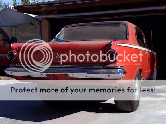

Hey Guys,
My dad and I spent the better part of the weekend trying to get closer to finishing this project.
We welded on the spring perches at -4 degrees of pinion angle.
We added the 3.91 gears.
The axle is finally in the car...hopefully I can leave it in for a while this time...
Here are some shots from my iPhone. I am sorry, the car is VERY dusty from sitting in the garage for a year. I ran out of time this weekend to wash it. My driveway is angled down toward the garage, so it looks a little more raised then it actually is. I cannot go any lower with the 315's. True to SS springs, the passenger side sits 1.5 inches higher.
I have some finish welding to do, then bleed the brakes, reinstall the gas tank, have a drive shaft built, then I should be back to driving it again. I am excited to actually have it out of the garage on it's own suspension and tires again.

Right on! Glad to see it on the ground. Looks old school bitchen too!
Hopefully mine will be on the ground this week also.
Thanks for the feedback. It definitely sits up in the back, like my car in high school with the hi-jackers air shocks...8)
I am excited to see how yours looks also. I will keep an eye out for pics.
Thanks,
OldMoparsRule!
