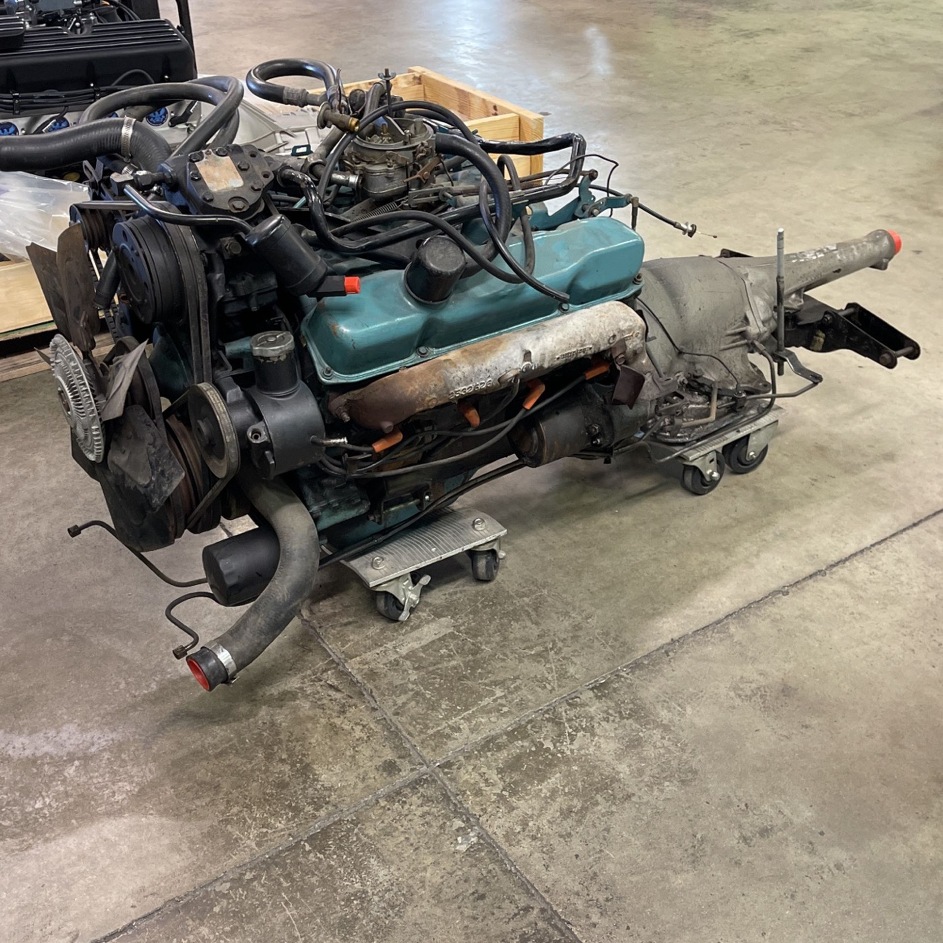

I just opened marketplace and immediately see this... LOL
mopar 360 v8
LA roller in good shape they say... 200 bucks
