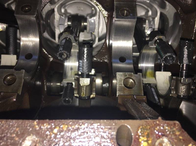

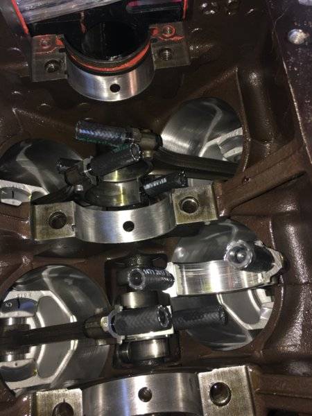

Looks to me like those two cylinders pounded the bearings. Spots on the back of the bearing and the spalling on the wear surface. Oil clearance and flow was probably fine because it’s not welded together. Good catch. Buy some assembly tools and fix it.

I’ll post pics of my main and other rod bearings as well...
Your oil pressure would have been ok during the test - there's a gage and sometimes a safety for that. 55psi IMO is a little low but should have been safe, and the bearing you show was not starved.

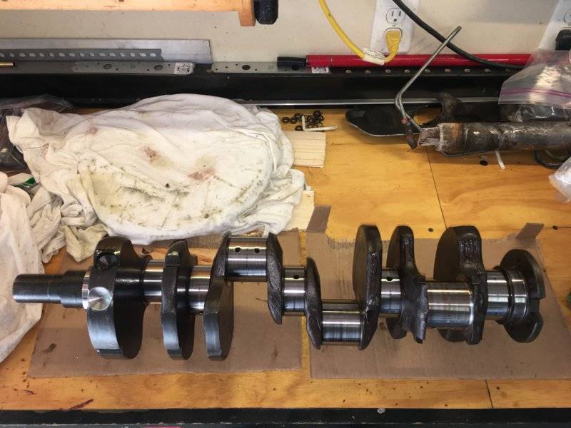

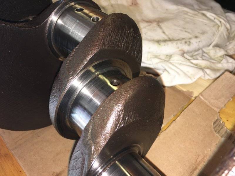

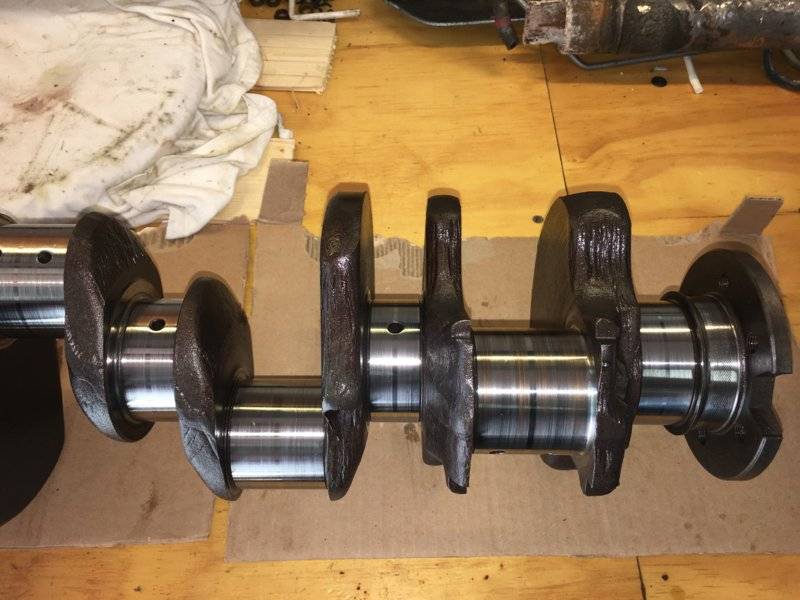

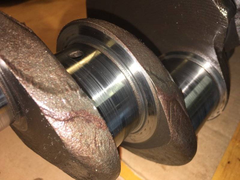

Crank...
I’ll be totally respecing this. A bit nervous to pair this crank with the block again. But lots of inspection on both still to come before the remachining decision.

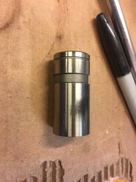

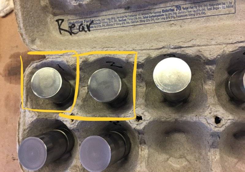

Another problem... I have 3 lifters that aren’t spinning. The lifter bores came back from the machine shop with a fresh new surface, but I’m assuming the bores of these 3 will be another problem to sort out.
I haven’t gotten to the driver’s side yet, but I assume I’ll see the same type of thing on that side.
Thinking roller everything now.
Drivers side look better, but the lifters for piston 7 looked like for a time like they were spinning and for a time they were not. Not sure which came before or after, but interesting that these two were associated with 7, where the potential oil starvation occurred.

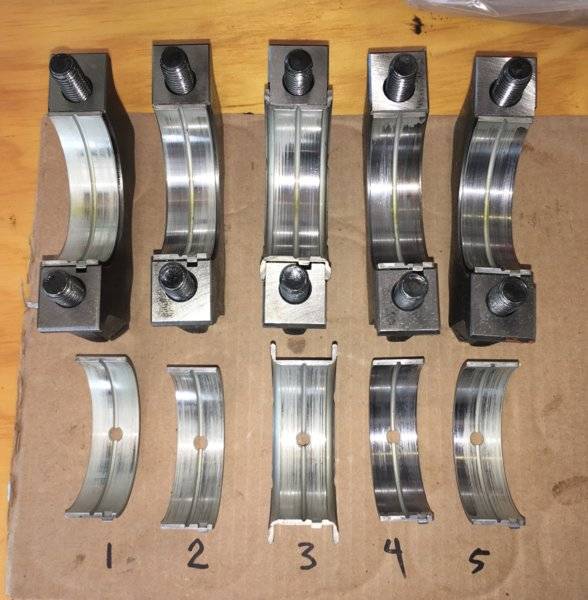

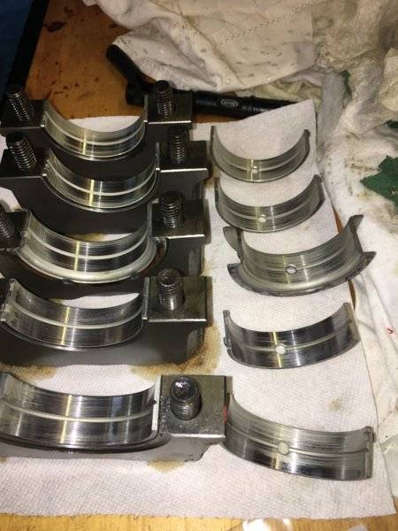

Shew! I hate seeing the bearings and crank in that bad of shape. The bearings look more like wear from abrasion. It could be from the wiped lifters, but it looks more like there was grit left in one of the oil passages. No oiling problems though. The crank should be fine if properly reground/indexed/polished.
Yeah.. the bearings look pretty bad, but maybe just because of the #7 and #8 bearing material that circulated thru? All of them are pretty scoured, but 7/8 rod’s are obliterated. I definitely checked the crank oil galleys before assembly, but didn’t manually check all of the block oil galleys, so I’m thinking that could be the source of the problem. I’ll get to that shortly.

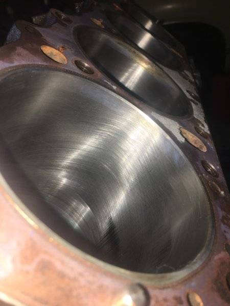

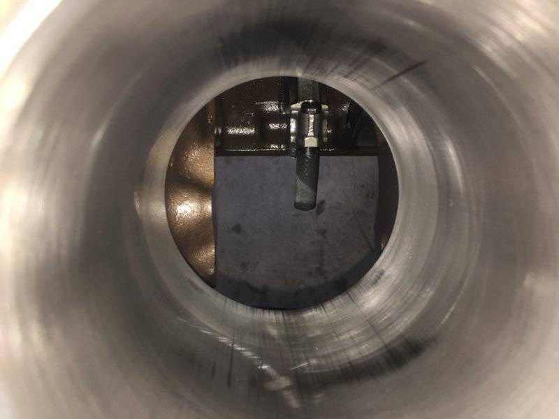

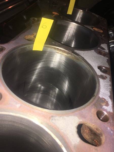

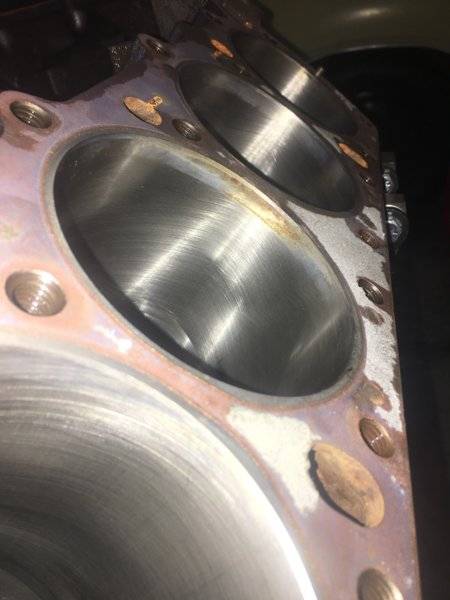

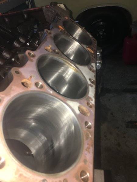

Cylinders, Pistons, and rings look good, except for #6 rod pin, which has some serious binding going on... this was not like that when I assembled.
#6 cyl has some rust/combustion res.?... it was assembled for about a year.. not ideal, I know.
