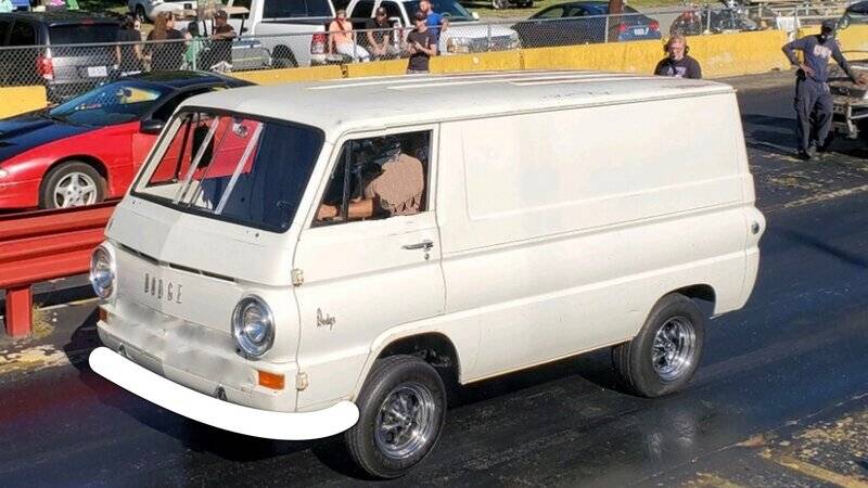

Aero mods are going to be the next step. Seal up some frontal openings, add a air dam/splitter, lower the van, rake the windshield back some....
I'd use some riv-nuts to mount the 'West Coast' mirrors so you can unscrew them for passes.
I wonder what kind of arrow-shaped plexiglass nose piece that you could put in the back and then bolt down for passive you can make...
I also think with his current pick of parts to throw on it, his headlights will become aircraft spotlights searching the skys. Keeping the wheelstands down low will be a major issue when that converter locks up.
Fiberglass is easy. For an air dam/splitter use some 1/8" steel rod, shape and weld up a bracket so its a bolt on to fit the body.
Then using Flannel shirt martial dipped in Polyester resin, stretch it over the rod bracket. Add some here and there to get the shape where you want it and then lay a layer of fine woven glass cloth over the outsides and some coarse chopped glass on the insides. Basic non 'Ribbed for her....' Condoms filled with moist sand can be shaped for curves and then popped to remove the sand. ;)
If you mess up, grind the bad section out and reglass in new.
Just a down and dirty mod to his picture:
All done with any more exterior mods, all engine and drivetrain related to get any further. Maybe lightweight disc on all fours, maybe!
The trade off of lighter disc's at 4 corners compared to less drag of drums. Discs are always dragging where drums can be adjusted loose. With loose drums you just have to step down on the brake pedal a bit more to remove the gap.
Yes some $$$$ disc calipers will pull the pads off the rotors.
Drums can be lightened down a lot. Turn them down till a few thousands less than MAX. Grind off the overlaping weather seal to the brake backer plate.
And you don't need super large TRUCK drums as the front brakes do most of the work and you most likely will not be hauling 1/2 ton of cargo....
I'd go light disc up front and lighter drums in the rear. Maybe a light weight driveshaft too.

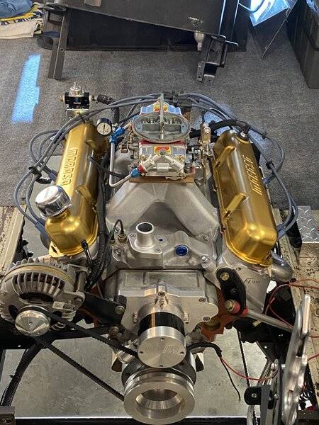

Aren't you going to have a top clearance issue with that M1 intake and the dog house?
No. With the airbox, carb and insulator it is fine. Just can’t play around with any of the various spacers most do.
Finally the Trick Flows and reworked M1 single plane are on, and changed cam plans with a custom Schneider solid over the Bullet solid, fast rate chatter here and elsewhere got the best of me initially but the more I weighed things the more I realized I just couldn’t do it. Also about a .5 bump in compression and (for time being) running the Current Turbo Action 3500 converter purely for shake down runs to determine exactly what stall I’ll need. Sometimes you shoot your wad too soon, think you have things figured and then end up going a different route. Money under the bridge......spending my “Biden Bucks” wisely! :rofl:Plans being made for a roll bar also. What the hell let’s see what we can f up next!:eek:
Nice looking engine, should be a runner. nice choice of parts
:thumbsup:
