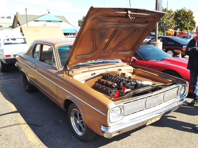

A friend just finished a 6.4/8-speed in his early Dart. Did it all himself. To say it's fast, is a bit of an understatement.

I'll see your Gen2 Hemi and raise it to a Gen3 and just be done with it. With an HP70 8 speed transmission

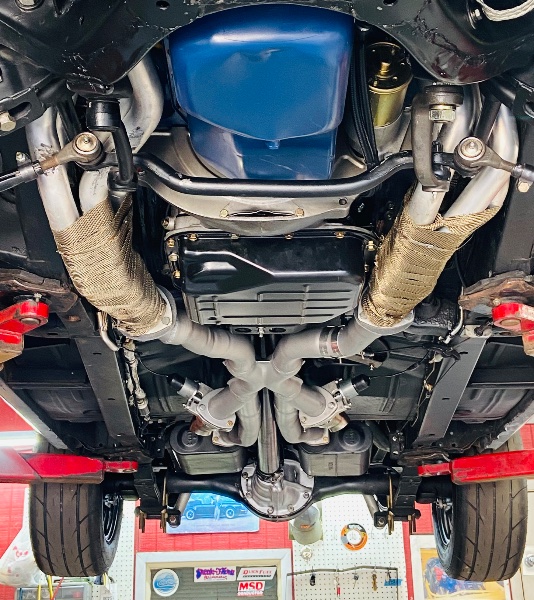

Mine is a 66, but I wanted to show you how tight the TTI’s are on the left (drivers) side of the 904…adjusting shifter cable or detent is next to impossible.

That does look tight. The dual exhaust on the /6 in the car now is super tight to the transmission as well. I could barely get in to adjust the shift cable.
