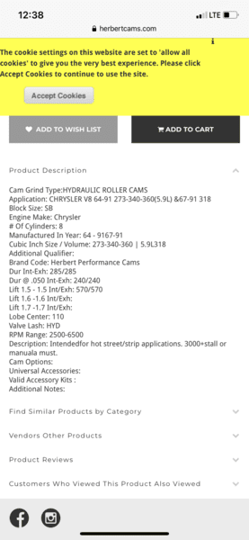

I had a local shop build a 422 stroker. 340 .060 over with a 4” crank. I have 9.5:1 compression because I wanted to keep the stock 2.02/1.88 J heads. I had the heads ported and they flow [email protected]. I have a non ported offy port o sonic single plane intake and hydraulic roller valve train. I will upload a pic of the cam specs. The shop called today to tell me they made a pull with a 750 Edelbrock carb and it made 355 hp and 421 ft lbs. I think it should be at least 100 more on each spec. Any thoughts on what the issue on my set up is would be appreciated.

Not that small of a cam. Lots of lift.. .570"

Non optimal carburetor, not great intake, and heads that peak @ 255 @600 lift mean nothing when your cam is way undersized for the cubes, as in your case. Its definitely a under performing engine based on there numbers, but you cant exactly trust dyno numbers either.

Wouldn't you think that cam would produce 1 hp / cu inch ?

I don’t see an issue with the cam. I’m figuring it’s the inability to breath. If that top end package was on a 340/360, I’d bet it would be pretty OK.

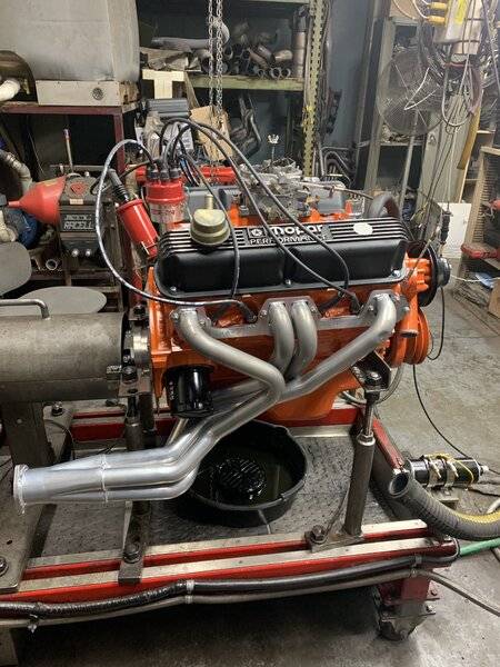

The pics show a Mallory Unilite distributor - is it electronic? How is it set up? Is that the coil they used? Seems kinda chintzy for a dyno cell. What ignition was used? Figure there would at least be an MSD box of some sort, preferably a digital one.
What size are the headers? They look like TTi 1 5/8"- 1 3/4" step headers. They're on the small side but they do work. Full exhaust in the car?
Do you have another carb to try? Most dyno shops have a proven unit they have on hand in case the customer's doesn't work.
