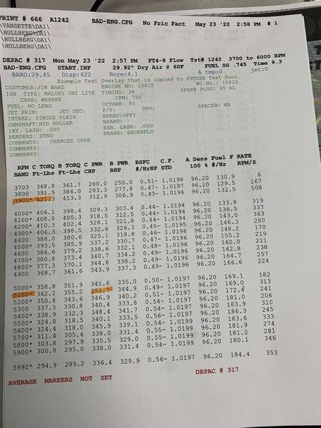

This was the sheet from yesterday.

I don’t see anything that really stands out as a red flag on the dyno sheet, other than the ridiculously low numbers.
That said, I’m confident that the issue with the low numbers isn’t that the “combo” is that bad.
Cam is in wrong, carb isn’t getting full throttle, timing mark on the damper is off, timing light is off, carb sucks, etc, is where I’d be looking.
Or...... the dyno is just wrong.
Even very mild stock engines will make over 1 ft/lb per ci on the dyno with headers.
This motor barely does it?
Is it “possible”? Sure...... but.....Not likely.
I’d be more inclined to retest somewhere else........ that’s known for producing good power from Mopars before I spent a bunch of $$$ on engine parts.

We swapped the distributor and added a 1” carb spacer and got 454 ft lbs and 380 horse. We will do more pills with the quick fuel 850 and Edelbrock air gap tomorrow. I will keep everyone posted.
For what it’s worth I chose to stay with iron heads. I paid pretty much what I could have bought a set of aluminum heads for to have the cast heads done and to work with the roller valve train but I knew that they would be limiting me for power. I’m pretty happy with the torque number and believe that will even go up with the dual plane air gap.
i agree.
This seams to be down like 50+ hp from where it should be.
there’s a bad part somewhere (a lot of that going around), something not working right, or a stingy dyno…
ported intakes, 1/8” more diameter headers, heads that support 500hp… are those keeping it 50 hp from reaching 1hp/cu in?
I believe we will get to 1hp per cube with the different intake and carb. I do know this dyno is very conservative which I want real numbers and not an inflated one so I can feel good but I was hoping for 1.2hp per cube. I’ll have to go to aluminum heads to get there it seems. All in time I guess.
