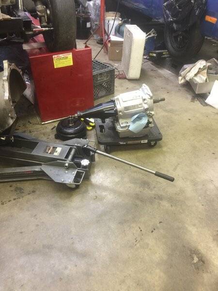

Pretty sure I’m going to go ahead and start pulling the transmission tomorrow since I have a brand new one ready to go. I also have a 5600 stall converter here too so I’m trying to cover as many bases as I can so I’m ready for the big SFG race coming up at Columbus the first weekend of September.

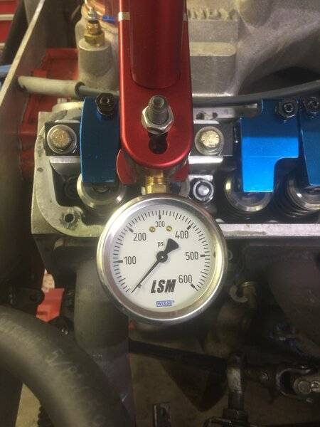

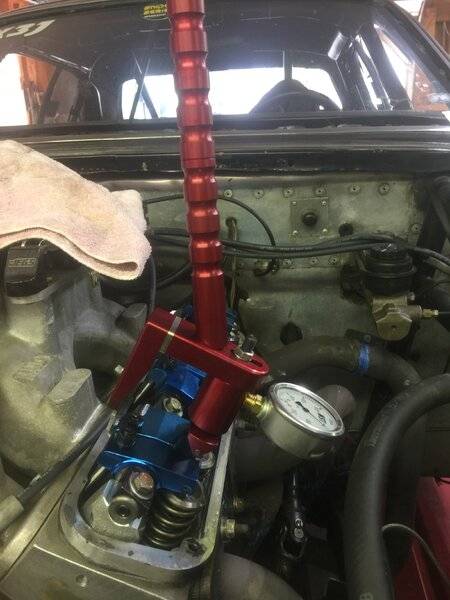

If you guys are looking for a nice but somewhat expensive tool for the wife to buy you for Christmas check these out. I should use it more often but being I shift so low I use it to check for a possible broken spring. Takes seconds to check once set up.

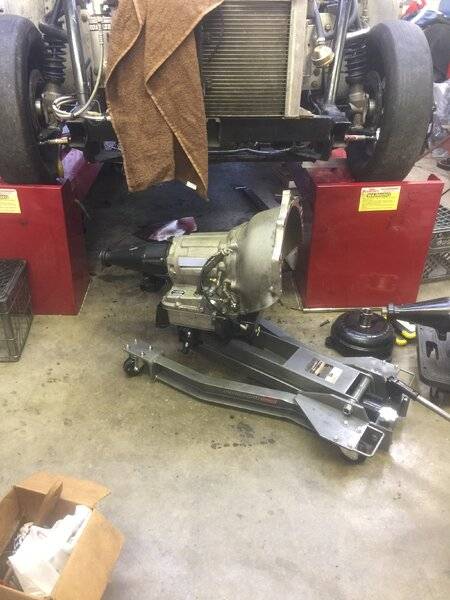

Powerglide yes. I cracked a stock case After all these years and caused a track cleanup so I thought it was time to do it. I now have three ATI cases and built a 1.69 low gear for my heads up car, a 1.98 which I just took out of my black Duster, and the 1.80 going in now. The bellhousing can be changed in about five minutes so if needed any transmission could go in any car.
Well I had a little setback. One of my studs ripped out of my powerglide mid plate so I called ATI and ordered a small block Mopar to powerglide bellhousing. It’s an update I’ve been wanting to do anyway. I ordered it directly from ATI and it will ship from Maryland tomorrow. They even beat Summits price on it.
