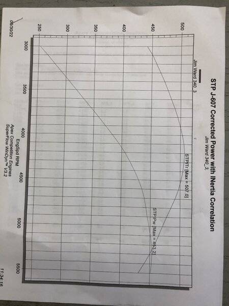

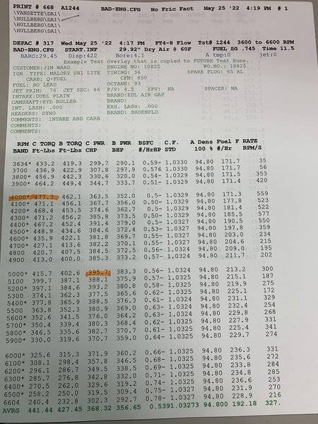

I took the motor to the shop that did the heads and they figured out some issues. First the distributor I used in the first session was junk and total advance was over 42 degrees, the spark plug gaps were way off with some as close as ten thousandths and with a proper tune including timing sweep and carb jetting it made 455 hp and 512 lb ft of torque.

Here is the best pull with the first dyno with the orange highlighter. The second is the best pull with 34 degrees total timing and after tuning on the second session.
