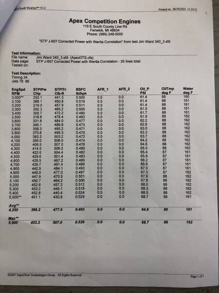

Jack with Valley did a great job giving my motor a once over and found the distributor to get junk (replaced with MSD), spark plugs gapped way too tight as they appeared to never be checked out of the box and the butterflies for the secondaries on the carb hitting the divider in the air gap intake. The motor liked 34 degrees best with 76 and 80 jets. Made 507 ft lbs and 455 hp. There was a slight oil leak out of the front of the intake so when he has it off he is going to gasket match the ports and it’s going in the car. I am a little short of my 500hp goal with the iron heads but he says with the heads milled a little to increase compression (currently he calculated 9.2:1) and a larger cam he believes 500 hp is doable.

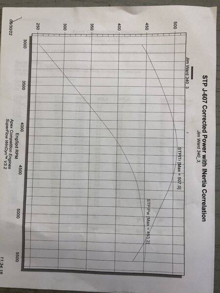

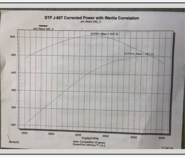

Jack just sent these to me.
The shop called today to tell me they made a pull with a 750 Edelbrock carb and it made 355 hp and 421 ft lbs. I think it should be at least 100 more on each spec.
Looks like you ended up right at about 100hp more, along with 85ft/lbs.
Notice how much better the bsfc #’s are(than the last sheet previously posted).
Same headers as the last test?
Same carb?
Any carb spacers tested?
Are the headers the same size as what was used in the first session?

When the engine makes noticeably more TQ than HP........when you break it down to basics....... it’s running out of air as the rpm increases.
Induction, head flow, head size, header size, cam area....... and usually, it’s a combination of several of those.
For NA street/strip type builds, when you get into that 1.25ft/lb per ci range, it’s not that easy to make the TQ go up significantly.
Shifting the tq peak up in the rpm band, along with trying to get the curve to fall off slower is what I usually attempt to do, when the tq number is decent, and the HP number falls a little short.
This usually comes at the expense of street manners and low end tq.
This is a quick fuel 850 race carb and that is exactly what happened.
Is there another page/sheet from that run that has the fuel flow and maybe the air flow numbers?
