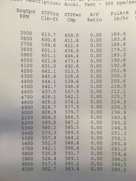

505 stroker fresh off the dyno - Power seems low? Thoughs?
Well pulling to 5800 isn't going to tell the complete picture, that cam, heads carb makes more power guarantee it. Dyno is right but it needs time to really break in
I’d be interested to know what the elevation of the dyno shop is, as well as the weather conditions for that day.
Not that those would have much impact on the corrected numbers.
However based on the fuel flow and bsfc numbers there was a fairly decent correction factor being applied.
(Looks like the uncorrected peak power would have been in the 520’s)
The bsfc numbers are pretty decent, so it’s not like the motor was using tons of fuel and not making power with it.
It just wasn’t using much fuel......... so there isn’t going to be big power being made.
The effective rocker ratio after the B3 kit installation looks like it works out to 1.435.
If the manifold isn’t ported, there is some power left on the table there.
At this point, I think the first thing is to see if you can get a cranking compression test.
If you go in with the inspection camera, see if you can get a look at the piston CH situation with the piston at tdc.
One thing that stands out to me is the peak TQ number is rather low for the sum of those parts.
So, the power starts out on the low side, and never really turns that around, so you end up with low-ish HP.

Notice it’s using quite a bit more fuel:
This pull was at 170* water temp.
A “hero pull” at 120* was made, and the results were over 650tq and 600hp.

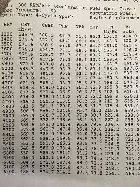

I remembered I tested a somewhat similar combo........ in 2008.
RB 512, 10-something CR, pump gas.
Prepped std port EZ heads, Holley SD manifold, HP950 carb, 252/261 roller cam.
I supplied the heads and did the dyno test, but didn’t build the motor.
Looking at this sheet now, it also leaves me thinking the peak tq output could have been a bit better.
This was a real street engine so it was tested with fairly hot water...... right up near 180*.
Another similar build to this one that used std port SR’s with mild porting and an M1 single plane....... but much more cam duration made about 75hp more than this one.
I didn’t supply the cam for this 512, although it was about right for the “application”.......... but if you were chasing the number on the dyno that would have been my first change.
You can see the VE never reaches 100%, and drops off pretty quickly as the rpm goes over 5600.
I wasn’t really a fan of the cam in that motor, but was still thinking it would break 600hp.......however it just didn’t happen.

One last(?) comparison......
I built a 10:1 493 probably 18 years ago or so.
This was a “hot street” type build that was going into a 70 Coronet wagon, with AC.
Prepped RPM heads, wide lsa cam for good vacuum, SD manifold for hood clearance, new Holley 850DP carb, 2” headers.
It made around 590tq/560hp....... which was about what I was expecting from what I considered a really mild build.
Granted the heads and intake weren’t as good as what the OP is running...... but both the tq/ci and hp/ci are very close between this 493 and his 505.
Around that same time, I re-ringed a customers 446 that had trw L2355’s in it.
The top end was basically the twin to the 493 above.
I was expecting it to make 540-550hp.
After one dyno pull I knew I had missed the mark with the combo and it wasn’t going to get there.
I ended up trying quite a few things on the dyno(intakes/carbs/headers)...... and was never as close to the “big number” as I wanted to be, so I ended up taking a big swing at the cam.
It didn’t make much difference with the intake/carb/header combo that was destined for the car, but with a big carb, my dyno headers, a Victor intake and a 2” super sucker....... it did get over 560hp.
But none of that stuff was going in the car, nor would the car have worked very well with that combo.
What i should have done was gone to a slightly smaller cam, tightened the lsa up a bit........ shot for a better TQ number...... and then “iiwii”.
When you’re putting together an untested mix-n-match combo of parts....... sometimes it doesn’t work out as well as planned(and sometimes it works out better than planned).

The dish in the piston looks pretty shallow, so I’d say it has the correct pistons in it.
It’s worth verifying the cam timing is correct, but 4deg off(on the degree wheel) isn’t going to yield 50hp.
But if the cam is retarded I could see that correcting it should bring the tq numbers up closer to what I’d expect.
The cranking pressure is in that zone where it’s hard to tell if it’s good or bad(it’s obviously not “way off”).
I don’t know if this was brought up or not, but which spring package did you get on your heads?
(That would only affect the upper end of the curve)
It’s surprising that shop has an expensive dyno....... and no air turbine? Crazy.
What are the intentions for the motor?
Street car? Bracket race car?
If the power doesn’t improve....... does it really matter?
If you haven’t read thru this one yet, it’s a good read:
Degreeing a Cam, or not.....
The springs are TFS-16893. Installed pressure of 120lbs at 1.875, and open pressure of 394lbs at 1.175. These are the springs that trick flow sends with their flat tappet 240 heads. I spoke to Howard's cams yesterday to pick their brains about things, and he was a little concerned about the spring pressure. He said he generally doesn't like to see more than 360-370.
Anyway, he recommended getting the cranking pressure up in the 185 region, moving in two degree incriments until it gets there. I'll be ordering the stall converter today, then get that in and get the engine dropped in quick. At that point I'll pull the timing cover and check/adjust the cam timing so I can crank it over.
I plan on 30% street and 70% bracket with the car. Just taking the kids to school, a few local car shows and such.
You’re getting a lot of info, some of it conflicting, from several sources....... so I’m just going throw a few things out there...... and hopefully not add too much noise to the conversation.
Those springs are a PAC-1903.
I just had a set of those TF240 heads here to look over. They had that spring package and they were set up right at 1.900” installed height.......115 on the seat.
The spring rate is 391lb/in.
Your gross lift you stated as .575” lift...... minus lash puts you at roughly .560” net lift at the valve.
391 x .560 = 219lbs, plus the 115 on the seat = 334lbs open.
Imo, nowhere near enough for a BB bracket race engine with a fast rate cam.
My guess is, Hughes sells more cams ground using that family of lobes from Howard’s than anyone.
Look at the spring specs they suggest for a BB using those cams.
Also, look at the specs for the springs Howard’s recommends(98632) for those lobes in a BB.
Calculate the open load at full lift for that spring if you were running the 720162-08 cam(I’ll give you a hint...... it’s a fair amount higher than 360-370).
The low-ish spring load isn’t a problem(rpm wise)....... until it is.
Was that contributing to the early power peak of your engine?
Hard to say.
Those springs may be your problem.
