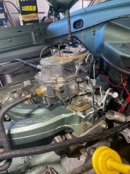

Ok, here's a report from a run yesterday~ my brother came over, he got in the far out back seat and chewie in the other, Gary riding shotgun;) AC was cooling groovily~ made it to the test drive range(A.D. Dyess park), got going along the chug chug almost died, did a bat turn and made it back to the garage.
Isn't it funny how a brain works, diagnosing along the way, what could it be?
Pulled the air cleaner and the carb was saturated inside and little to do pump shot from the accelerator pump. So I pulled off the carburetor, easy enough, pull the top of the carb off, nothing jumped out at me, but did notice the rubber part of the accelerator pump seemed, limp, flimsy. ha, I just happen to have that rubber part~ have no reason which comes to mind why I have it, but put it in, seemed less flimsy, then fought the metering rods to get the top of the carb back on. Have to keep in mind this carb has been ran for a decent amount of time over the past few months.
ok, here comes the stupidpidity thing, I "adjusted" the tab on the float thinking it wasn't allowing gas to get in, but I made it too tight actually cutting off gas getting into the carb. Take the carb back off, re-adjust, check the fuel pump for fun.
LSS, it's running now, but I'm not sure If I did anything. This is a knock off carburetory from Amazon. I am planning to buy a good carburetor, just haven't done it yet. So any ideas on this would be a good time to chime it.

Don’t feel bad , my Holly 1 v had to have starting fluid to start and had to be thoroughly warmed up before you could even try to accelerate.
I pulled it apart and found that the accelerator pump diaphragm was completely stiff, unable to move, nada .
I ordered a carb kit from Rock Auto for $58 , it’s a Standard Auto parts kit. I had priced a kit from NAPA they wanted $85 ,I asked why so high they said it’s becoming obsolete.
Well now the accelerator pump works like it should. I believe the 10% Ethanol gas is the cause.
Back in 2017 I rebuilt the carb with an old kit that was made before Ethanol started being mixed in. I also blame it for taking out my fuel pump then .
Hopefully the new kit came put up with the new fuels .
This is a stopgap repair as I want to install my Offy 4 v manifold with throttle body injection .
I just swapped a float on my carb and the arm was bent slightly. Well bad enough so that I could crank the needle until I ran outta threads and it wouldn’t shut off the flow. I bent it a little bit and it worked.
Junk in the needle is my first go to usually….

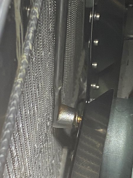

Hi George, this is my new fan, I used the same spacer as before~ it's about as close to the radiator as I can get and also the other direction~ or "centered". I had bought a "fan wrench", a vintage Snap-on tool for the job which helped a great deal.
I would like to see a picture of your new quieter fan setup in place.

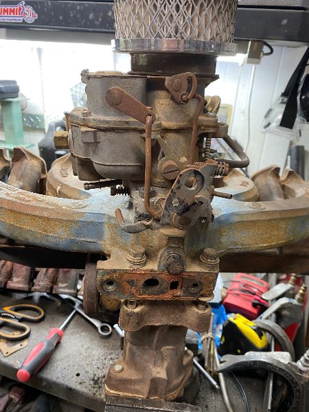

Thank you Mike, I'll be looking out for another carburetor~ but in the meantime, it's running, I wouldn't say great. Yesterday I unscrewed the mixture screws just about until they fell out, and all the way in~ just nothing happens lol. Going for a ride as soon as I can get my body functioning this morning. So I'll be back in a little bit.
I think what barbee was trying to say is crud can get caught in infinitely small passages in the carb and reek havoc. The idle air bleed slots in most carburetors are so small, just about anything can clog them. If it's a new carburetor (I think I remember you saying you bought it new, but that it was a Chinese source), it may just not have port sizing right (speaking of the idle circuit stuff). It might work better if you use a used and rebuilt 318 carburetor from a 1960's or '70s engine. I've had carburetors that I just couldn't tune, only to switch to another that -- on paper -- was identical, and have incredible success. The defunct carbs looked perfectly normal when I dissected them. Go figure!
This is the carburetor that came with the two barrel manifold. I didn't know what kit to install, so I just bought the Amazon, now I'm looking at this carburetor again. :lol:
