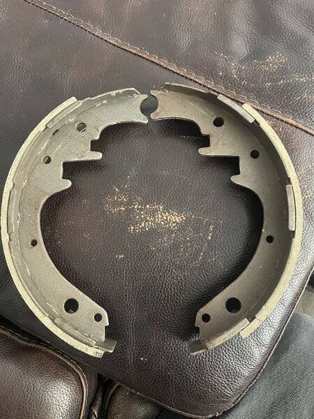

So to help start things, the most commonly available shoe is the 331. It was used starting in 69. It is also the only shoe currently produced.
The photo is a 331 shoe and it has the bent over tap where the shoe rides on the backing plate as well as the adjuster pivot pressed into the shoe next to the star wheel.
Now that I’m home. Here is a photo of the 256 frame shoe. It would be “correct” for your 65. Notice the area where they ride on the backing plate does not have tabs. Also there is no pivot for the brake adjuster. And the ear above the star wheel is shorter
And finally the 288 shoe. This is correct for my 68. Notice it has the tabs for the backing plate no pivot pin and tabs over the star wheel are also short.
Now I have found guys here on FABO that have said they used the 151 frame shoe and had satisfactory brakes. (151 is the Phord mud-stain 10x1 3/4 shoe. I haven’t tried it but seems promising. I have compared the 256 and the 151 and they seem to be identical. But appearances can be deceiving
