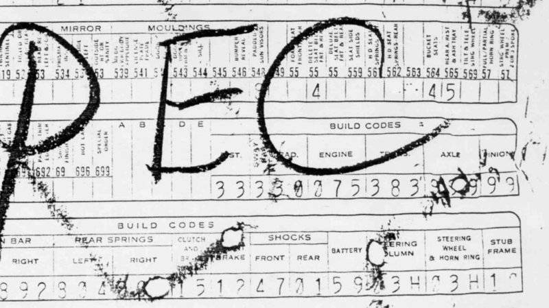

Perhaps somebody with a D/Dart broadcast sheet could chime in. Those are the only early A-bodies that there is no doubt as to what rear end was factory installed. Actually, I think I may have a copy of one. I'm looking right now.
Interesting. 408 is still Sure Grip. 409 is special order rear gear. @ddartdude knows I bet.
I think so. Now we need to see a late '66 standard four barrel four speed car to see what it says. Unfortunately the axle info is right where the seat spring was.
Mine is a December car. Post #52
40"4"= 3:23 gear ratio
40"8"= sure grip
Neither indicate size of ring gear.
To know which rear was installed at the factory, check "axle" under the build code section of a build sheet. For my 66 with 3:23 sure grip, the build code is 011 and it is a 7 1/4" rear. Someone with a factory 8 3/4" A body car, please post that number.
66 Barracuda 4 speed 273 2V 8 3/4 suregrip. Pretty sure it's 138.
D/Dart broadcast sh
The axle is #999 and the pinion is #99. From another D/Dart broadcast sheet.
Makes sense. Many of those build sheets are quite hard to read. Along those same lines, fender tags can be almost unreadable if rusted bad. Flip it over and take a sharp photo of the backside and I can invert the image to make it readable.
